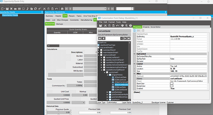

Estimation wants to add a small “Historical Data” group on the Quote worksheet with 3 Part-Advisor-like fields: Last Quote, Last Sale, Last Cost.
I know. Just use Part Advisor…

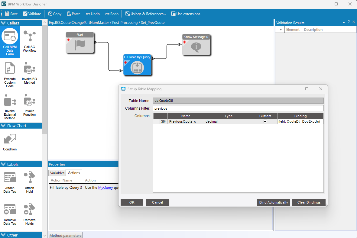

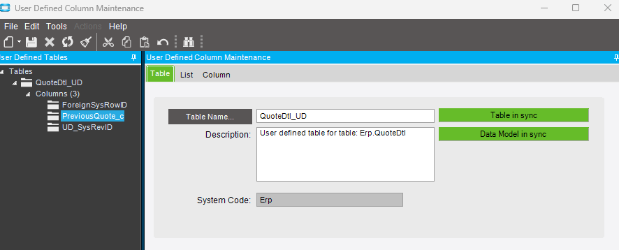

Anyway, I’m starting with Quote. So far I tried a UD field on QuoteQty, bound it to the new control, and I’m attempting to set the field via post-proc BPM on Quote.ChangePartNumMaster. But so far all of my attempts to fill the UD field by BPM Query have failed and produced errors. Should I be doing this via an event somewhere in the customization and using C# instead?

Okay I will show my work to the class prepare to be impressed.

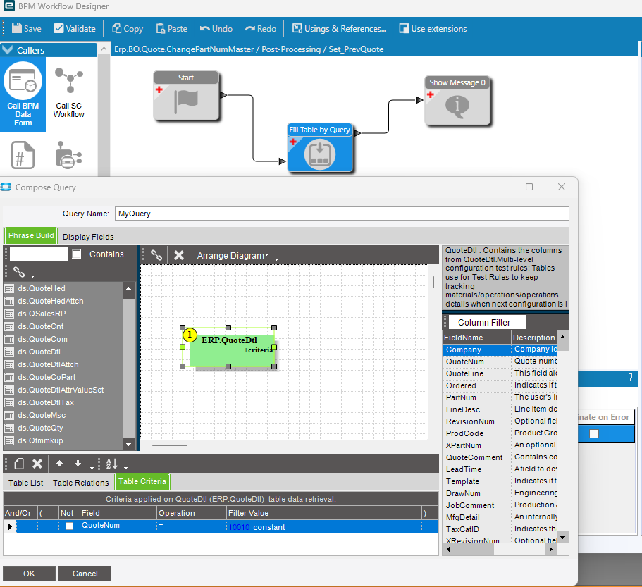

Error message: Failed to enable constraints. One or more rows contain values violating non-null, unique, or foreign-key constraints. (full text at the end)
At this point I’m just trying to achieve pulling any data from any db row into the column so I tried filtering on a specific QuoteNum.

Your query is pulling more than one line. Need to be more specific.
I’d use the setfield widget, and something like this on the changed row:
Db.QuoteQty.Where(x => x.QuoteNum == oldQuoteNum && x.QuoteLine == oldQuoteLine).FirstOrDefault().DocUnitPrice
I am more than a little embarrassed to admit I did not realize until this moment that you can just type C# into a set field expression like that. And you were right about the constraints too. Thank you for being so amazing.
