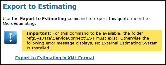

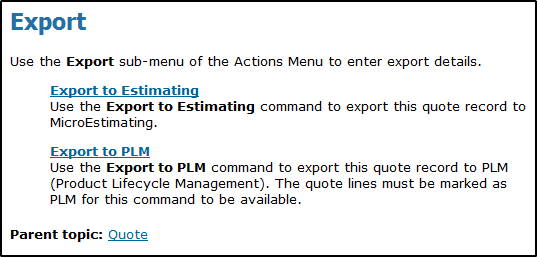

This is from the 10.2.200.7 Help file.
Something to do with MicroEstimating
Here is a little more
