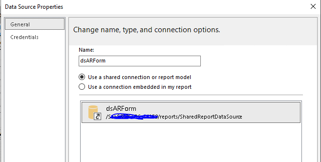

One thing I just noticed that in the Data SOURCE properties from Report Builder, it refers to our Cloud Server,/reports/ SharedReportDataSource .
Am I pretty much out of luck getting to the RDD I created/modified due to being a cloud customer ??

I have done stuff like this before but that was on premesis, I think there is more to the connection string than windows/server auth on the cloud…
No, you should be able to modify a copy of the RDD.
Your error message had nothing to do with too many columns, right?
You will NOT be able to link to the SQL server like an On-Prem user.

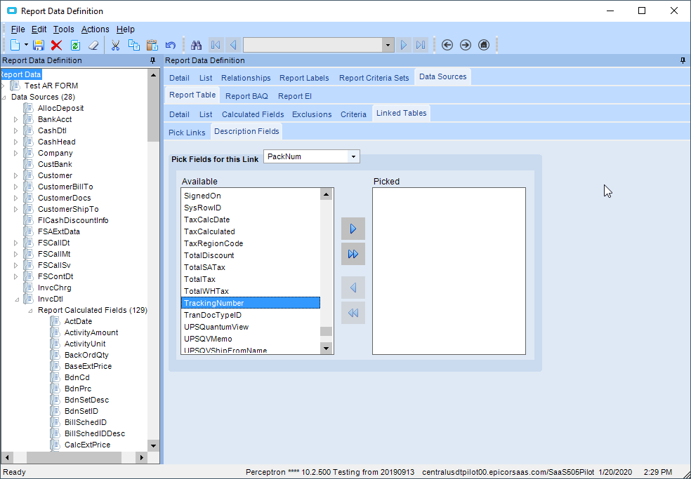

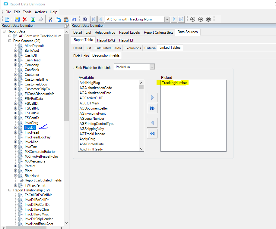

The Linked Tables feature is the easiest way to add data to an RDD if the linkage exists. This is how I would add the tracking number (above). The name will appear as Shiphead_TrackingNumber or something like that. Make sure to add it to your SQL statement in the RDL.
Yes, you can have multiple shipments on an invoice so the InvcDtl is the correct table. The Relationship entry is not required. The Pick List will do that for you. No Join required either. You’ll find the field under the InvcDtl set with a name like ShipHead_Packnum or something similar. Once you have that name, you add it to the T1.InvcDtl_ShipHead_Packnum … or whatever the name is…I don’t recall the convention at the moment.
Thank you Mark and Calvin,

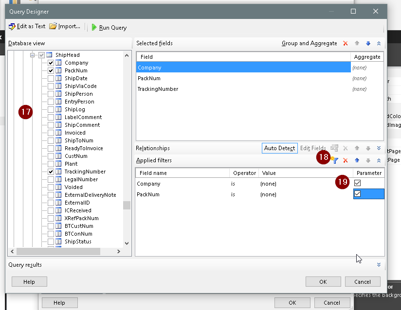

The last piece of the puzzle is the syntax for the RDL select statement. It is T2.PackNum_TrackingNumber. Also worth noting is that you must use PackNum_TrackingNumber on the Field Source of the Dataset Properties I did leave the Relationship in place on the RDD.

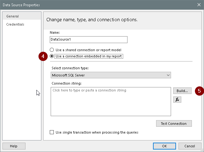

Sorry for bumping this old thread but I just wanted to say thanks for your step by step tutorial on creating a subreport with an embedded data connection!
Our UK office needs a customized AR Invoice for Brexit which requires the Country of Origin be displayed for every part/invoice line. The ISOrigCountry field is available in the Linked tables of InvcDtl but it contains the country number and not the country description. So I created a subreport to connect to the Country table and grab the Description.
