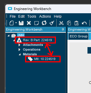

I don’t know about y’all, but I think this here may be the culprit…
Mtl Sequence: 10
Part: 224519 will cause an endless loop in method defined for Part: 224519, Revision: B, AltMethod: .
(Asm Part: 224519, Asm Rev: B, Asm AltMethod: , Mtl Seq: 10, MtlPart: 224519)
That would do it. You can manually set low level code on the part master back to 0. Bottom right hand side.
