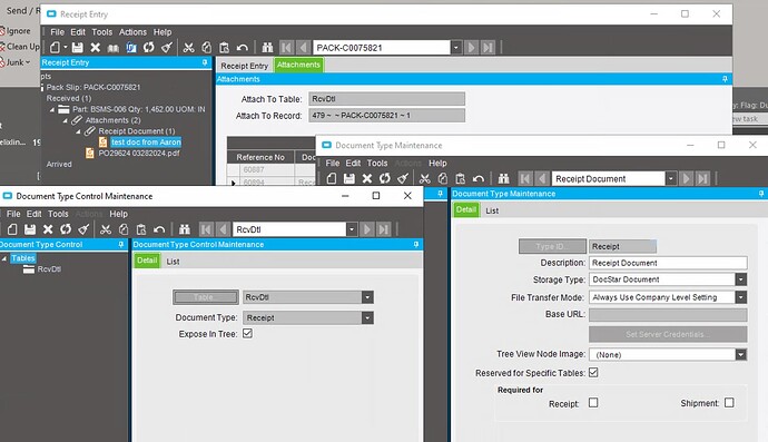

It is our first time using this checkbox and I can’t figure out what Receipt Entry needs me to do to satisfy the Receipt Doc check. I created a Document Type in Epicor called Receipt Documents. I tried enabling it on both the RcvHead and RcvDtl tables.
Then I attached the document to the receipt but still get the message “Receipt Documents required for lines 1,.”. Are there some extra steps that I need to take?
First I tried the header, then I tried the line. I get the same result on both.
Interestingly it let me delete the test attachment from the header, but when I try to delete it from the line it says “At least 1 receipt document is required. Cannot Delete attachment.”

If you mark both the header and detail as needing receipt docs, then you need to add at least one document at each level. Are you sure you added the documents under the correct document type?

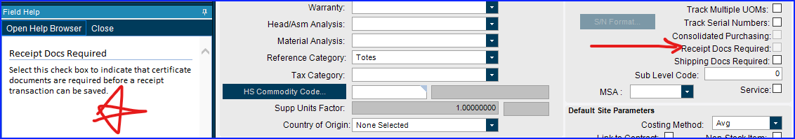

Neither the header nor the detail are “marked as needing receipt docs”. This pop-up message about needing a doc is being triggered because “Receipt Docs Required” is checked on the Part in Part Entry. We don’t want to require docs for ALL receipts, just for specific parts that need a doc.
The way I have set it up in the past is to have a specific Document Type that is needed (mine was called “Certs”). I also had other Document Types on the receipt like “Packing Slip”. This way, you can write your procedure to say that if the system barks at you for a document, you need to add the certs to make it go away.
What is happening to you right now is that it says the part requires a document, but you have not told the system what Document Type is required. You will never meet the requirement until you check that box.
