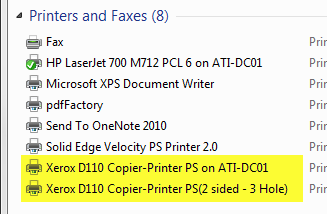

One thing I’ve done in the past is to setup multiple instances of the same printer on the workstation. I might have printers: “ENG-HP600” , “ENG-HP600-Land” , “ENG-HP600-B-Land” , etc…
They all point to the same printer, but each has it’s default settings (paper size, orientation, color/B&W, etc…)
For example, I have two “printers” setup for the one Xerox D110 printer we have.
The first defaults to letter size, portrait, single sided, no staples or holes.
The second is letter size, portrait, double sided, no staples, 3 holes.
Then When I print from a program, I just select the printer and don’t have to change the settings.
One down side to this is that some printer installation programs do you the “favor” of only allowing one “printer” for each physical printer.
