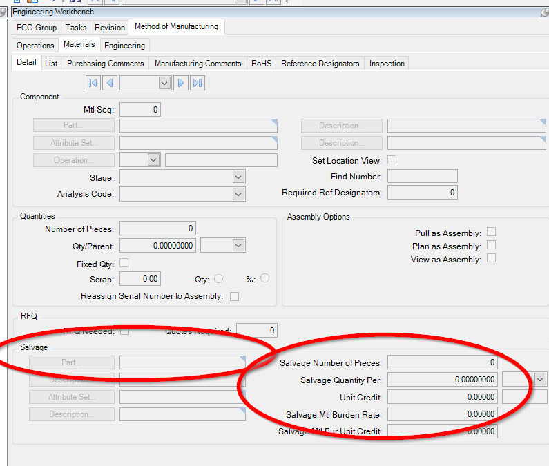

Where I used to work, we had a “Box” that we sold. (lets call that “Box1”)… We found that we could purchase the box, but it had a “Terminal Block” attached to it (lets call this TB1). Box1 didn’t need the terminal block, BUT, we needed TB1 for another product. Soo… we created three parts:
  1. BOX1 - the sellable part (this had additional manufacturing on it as well)
  2. TB1 - the terminal block
  3. BOX2 - the PURCHASED PART that included the terminal block.
we would sell BOX1… this would create a JOB for BOX1. the BOM for BOX1 called out a BOX2 on the BOM. the Material Detail tab in engineering workbench we entered the SALVAGE part number of TB1. The result was a purchase order demand for BOX2… a job for BOX1, and when we finished the operation to cut off TB1, we “Salvaged” the part from the job. This is easier than coparts, because… well… it just is.
