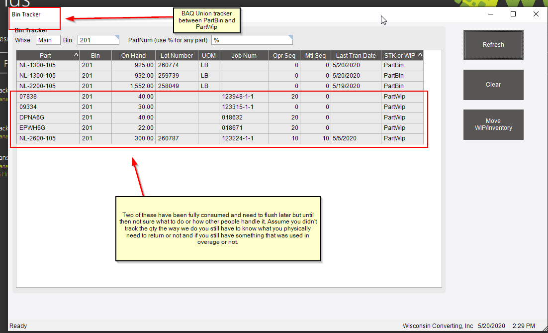

Because we have to closely track the qty to make sure we don’t lose materials or finished goods. If you have the AMM module all of the WIP location stuff is tracked in an inventory-esque fashion but it’s handled and transacted very poorly and with lots of bugs. Lots of BPMs to make it work as you would expect. I know that it sits there until it gets flushed at close, but it shows as physically there yet with AMM as well.
Our Bin Tracker that takes advantage of AMM tracking location

The issue is knowing what qty on the floor is real and what is not. So for example if accounting wants to reconcile WIP in Epicor with reality, they would go to the machine with the remaining 120 and not see a 120lb roll of paper because it was physically consumed. Then they question is it lost, has it been consumed, where is it.

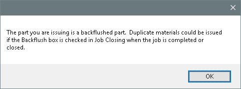

I just tested it, and back flushing appears to ignore any prior issued Qty’s. On th eplus side, trying to issue materials to a job that are marked as Backflush, warns you with:
