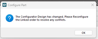

Reconfigure Orders after changes (solution in BPM?)
We have a lot of orders and in our configurator all the details are tied to UD tables.
Anytime even the smallest change happens, we get an error message saying an order needs to be reconfigured.
With the amount of orders we have, this is a never ending battle and causing jobs to not create when MRP runs.
Is there any way to have BPM do a process that just opens and resaves the configuration so it can update and not slow down our MRP?

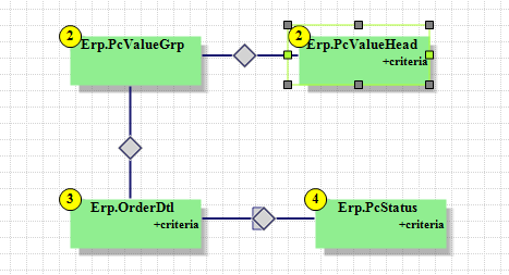

I got you buddy. We had the same issue. We do it using a UBAQ/dashboard (so it forces a user to at least review the order # / basic info before arbitrarily updating it). But you could do it with a BPM if you were so inclined. The key is to update the PcValueHead.ConfigVersion so it matches the PcStatus.ConfigVersion for the given configurator. Our BAQ is structured like this:
Will this just stop the warning but not fix this issue? I probably should have attached this before. We get this error message when trying to create a job and someone has to go to an order and literally just open it and re-save it.
The “verify existing configurators” menu option will attempt to handle changes to the configurator for existing quote/order/jobs. The log file will list those that can’t be resolved. The situation you indicate the verify process should handle most of your issues.

This assumes that you don’t actually need to update anything and just open and resave. Yes this makes that error go away. The “Verify Existing Configurations” was sporadic for us when we first started using it. I will try it again and see if it is working now. Intially we were on 10.2.300 and I am suspecting it might’ve been broken in that version. That’s what led us away from using it in the first place. But if that doesn’t work, you can sync the version numbers. That’s what prompts that error message to pop up and prevents jobs from being generated.
