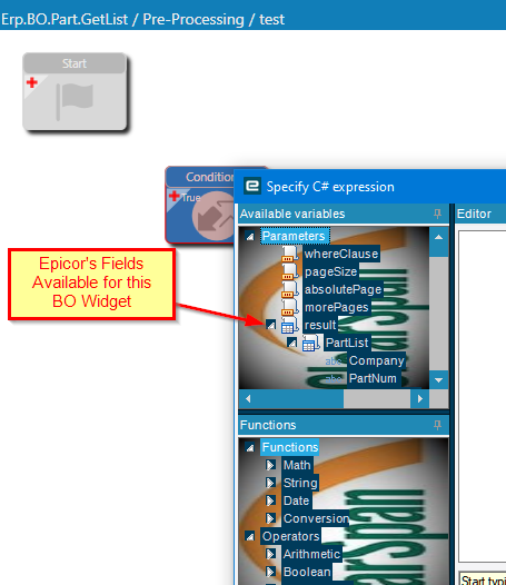

Not 100% sure. I would use the drop downs in the BPM designer to make sure you have the correct ones.
Please pardon my inexperience, how do I get to the drop downs?
Double click the field you’d like to use, and Epicor will put it into the expression editor with the correct nomenclature for your version.

Thanks everyone for your help. I reached out to another guru for some help on this and I think some of the issue may have been the version (2023.1.10) we’re on but not exactly sure.
The end result was a change to the C# code in BPM1. This is the code I used, and it works as described in @timshuwy document:
result.VendorList.RemoveAll(row => row.GroupCode == “PTNR”);
