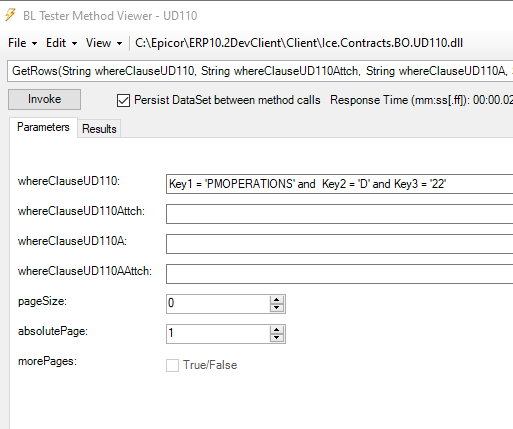

If you’ve already installed BLTester…
Perfect. I have that. Now how would I say Key2 = ‘D’. Key3 = ‘22’. Do you separate with something?

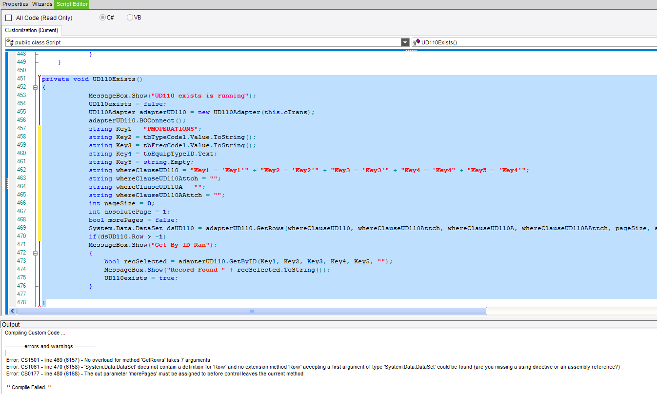

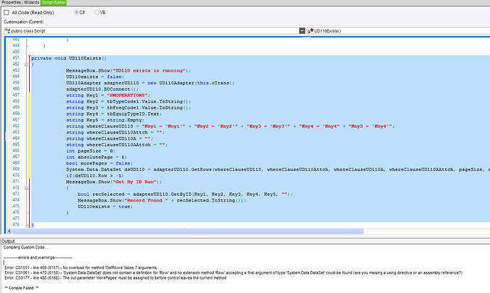

Okay in BL Tester I got this to work:
Now how do I translate that into my code? This is not compiling
			MessageBox.Show("UD110 exists is running");
			UD110exists = false;
			UD110Adapter adapterUD110 = new UD110Adapter(this.oTrans);
			adapterUD110.BOConnect();
			string whereClauseUD110 = "Key1 = PMOPERATIONS";
			string Key2 = tbTypeCode1.Value.ToString();
			string Key3 = tbFreqCode1.Value.ToString();
			string Key4 = tbEquipTypeID.Text;
			string Key5 = string.Empty;
			System.Data.DataSet dsUD110 = adapterUD110.GetRows(string whereClauseUD110, string whereClauseUD110Attch, string whereClauseUD110A, string whereClauseUD110AAttch, int pageSize, int absolutePage, out Boolean morePages);
			//if(adapterUD110.GetRows(Key1, Key2, Key3, Key4, Key5))
			if(dsUD110.Row > -1)
			MessageBox.Show("Get By ID Ran");
				bool recSelected = adapterUD110.GetByID(Key1, Key2, Key3, Key4, Key5, "");
				MessageBox.Show("Record Found " + recSelected.ToString());
				UD110exists = true;
Take the first string out of this:
I don’t think you need it because you already gave it a type when you assigned something to it above:
string whereClauseUD110 = “Key1 = PMOPERATIONS”;
Also, what is the compiler saying?
			string Key1 = "PMOPERATIONS";
			string whereClauseUD110 = "Key1 = 'Key1'" + "Key2 = 'Key2'" + "Key3 = 'Key3'" + "Key4 = 'Key4" + "Key5 = 'Key4'";
			string whereClauseUD110Attch = "";
			string whereClauseUD110A = "";
			string whereClauseUD110AAttch = "";
			int pageSize = 0;
			int absolutePage = 1;
			bool morePages = false;
			System.Data.DataSet dsUD110 = adapterUD110.GetRows(whereClauseUD110, whereClauseUD110Attch, whereClauseUD110A, whereClauseUD110AAttch, pageSize, absolutePage, morePages);
				UD110exists = true;
These are the errors:

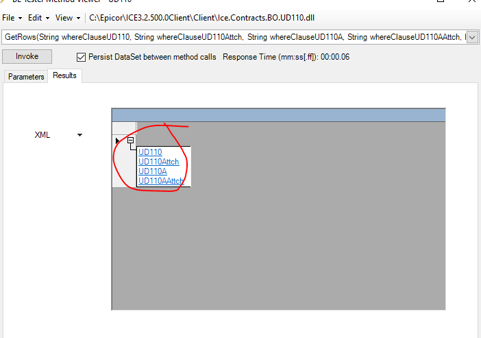

Your row issue I get, you have to select a table in that dataset. I can’t tell you the syntax cause I’m kinda new at this, but you need to do something like dsUD110.Table.Row… something like this maybe?
if (ud100Adapter.UD100Data.UD100A.Rows.Count > 0)
return ud100Adapter.UD100Data.UD100A[0][“Character01”].ToString();
The overload thing is confusing me because it is acting as if we aren’t passing it the correct amount of overloads when we are… I am trying it on my side too.
EDIT: What I am seeing @skearney is maybe that we need to use something called SearchOptions for the first parameter and then out more pages so that we have only 2 parameters total.
I think you assign all of the keys in search options so that the search returns your rows. Do some digging on SearchOptions.
Alright, so I don’t know what searchoptions are or how we are supposed to learn about them. I don’t see many posts on here about them or how to construct/add to them, but I borrowed some code from some other post that seems to work so that we can get our GetRows() method to work…
Firstly, your GetRows method only takes two parameters (not sure why the BL testers show so many more). The method takes a SearchOptions parameter and an out paremeter:
adapterUD110.GetRows(opts, out morePages);
So for your code you should do this (remember that I borrowed this code so I am not sure what I am telling you to do here with the search options object- full disclosure):
string wClause = "Key1 =  ' " + Key1 (this is your variable per your code) + " 'and Key2 = ' " + Key2 " AND SO ON AND SO FORTH FOR ALL YOUR KEYs. MAYBE TRY JUST USING ONE KEY AT FIRST;

But there is the change… you need to select the table first before you select the row
When you ran your BL tester you will see that you need to specify the table that you want in your dataset (there are mulitple). This can be seen when you run this in your BL tester as seen below… You can see that there are multiple tables UD110, UD110Attch,UD110A, etc…

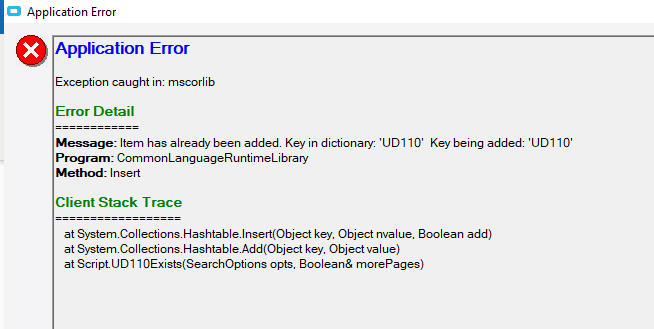

Okay, for saying you don’t know too much you sure sent a lot of good information. From your info this is what I have so far:
			morePages = false;
			System.Data.DataSet dsUD110;
			try
			string wClause = "Key1 =  ' " + Key1 + " ' and Key2 = ' " + Key2  + " ' and Key3 = ' " + Key3 + " ' and Key4 = ' " + Key4 + " ' and Key5 = ' " + Key5 + "'";
			MessageBox.Show(wClause.ToString());
			opts.NamedSearch.WhereClauses.Add("UD110", wClause); ////Error Here
			MessageBox.Show("Before getting the Data Set");
			dsUD110 = adapterUD110.GetRows(opts, out morePages);
			MessageBox.Show("After getting the Data Set");
			if(dsUD110.Tables["UD110"].Rows.Count > 0)
				UD110exists = true;
				adapterUD110.Dispose();
	catch (System.Exception ex)
		ExceptionBox.Show(ex);
That code works perfectly if a record exists and it sets the UD110 exists to true accordingly.
However, if a UD110 record doesn’t exists I am getting an error where I have shown it in the code. Attached is the error.
Any ideas?
