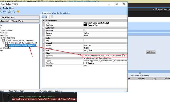

Cant you get the guid of the control, and cast it to the proper type (as shown in explorer)?
var SelectPanel = (Erp.UI.App.SelectSerialNumbersEntry.SelectPanel)csm.GetNativeControlReference(“ea240c45-ea82-4a87-b2b6-067e37c94b7f”);
SelectPanel.Focus();

Use the Custom XML editor and find your controls in there if you dare. You could use the ParentControlKey property (= panel guid) to find on the beast that live under that panel.
You may have to do that again if you find additional hierarchy below that (other sheets, panels, groupboxes, etc)
Once you get the guid and the type, you can wrestle that bear

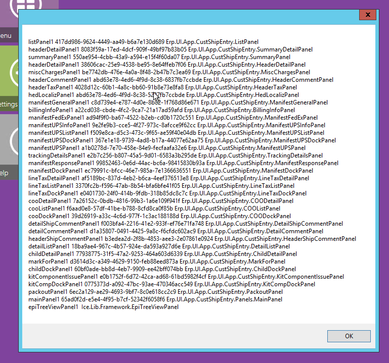

If you like hacky workarounds you’ll love this. Get all the panels and their GUID of your form (be sure to change your form name)
	private void PanelCheck(Control control)
	if(control == null) return;
		if(control.GetType().ToString().ToLower().Contains("panel"))
			EpiBasePanel pn = (control as EpiBasePanel);
			string guid = "";
			if(pn != null)
				guid = pn.EpiGuid;
			var res = string.Format("{0} {1} {2}\n",control.Name,guid, control.GetType().ToString());
			controlslist += res;
	private void ProcessAllControls(Control rootControl, Action<Control> action)
	    foreach (Control childControl in rootControl.Controls)
			if(childControl != null)
		        ProcessAllControls(childControl, action);
		        action(childControl);
	private void CustShipForm_Load(object sender, EventArgs args)
		// Add Event Handler Code
		ProcessAllControls(CustShipForm, ctl => PanelCheck(ctl));
		if(controlslist != "")MessageBox.Show(controlslist);

So that get’s me all of the panels, If I change “Panel” To “Grid” will that get me all of the grids?
p.s. getting GUIDS in a window that you can’t copy and paste from is just cruel… I may have to add a write out to text file…
You can do a Ctrl+C to copy the message box text.
Also, see this post.
Thanks for the tip! The feedback when you do that makes it seem like it won’t copy, but lo and behold it does!
