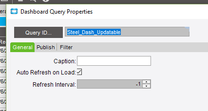

This one seems so basic…I would like to refresh this dashboard on a set interval (every 10 minutes or so). I see the Refresh Interval box on the query, but it reads -1 and I can’t seem to change it. Any thoughts?

Dashboards aren’t my area at all, but, if you deselect Auto Refresh on Load does that do anything to the refresh interval field? If that doesn’t do anything, if you reselect Auto refresh on Load does refresh interval become exposed?
I noticed you have the word “Updatable” in the BAQ ID. Is the Dashboard query you’re trying to change the primary one? Or is it a sub dashboard fed by another?
Alas, the “Auto refresh on load” doesn’t appear to affect the Interval field. Thank you though.
This is a simple dashboard that shows receipt lines as they come in. It only contains one updatable query that allows update of the RcvDtl.ReceivedComplete field for partial shipments. Does the fact that this is an updatable query have any bearing on the refresh interval?

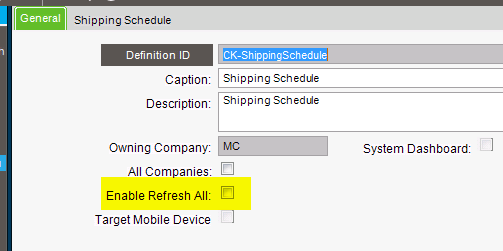

EDIT : One more thing… Is the Enable Refresh All box checked on the General tab? Not that I think it should be.
I think it has to do with an updateable BAQ. I checked some of mine and it follows that logic. It also looks like it doesn’t matter if you actually use the dashboard as updateable or not. The setting is before you would get to that point, so it’s simply the fact that the BAQ is updateable. You could make a copy of it an uncheck the updateable check box in the BAQ if you want to use it as non-updateable. I think it should work then.
Think about it from a programmer and end user perspective. If I had a dashboard that I was making changes to, how mad would I be when it refreshed in the middle of my changes? I think they disable it on purpose because they don’t want that to happen.
