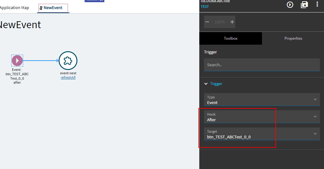

So this is pretty easy to do unless I’m missing something. Simply wire an After Event on the Built in Action (button) event that invokes the Refresh Event.
Seems to work pretty well.
BTN_TEST_ABCTest_0_0 is the event that is natively raised when you click the Custom Action button (I named by action TEST) on the dashboard

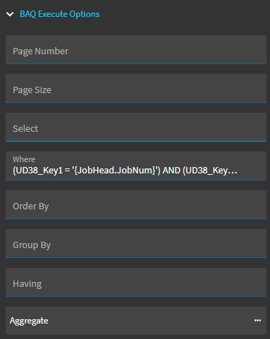

Reviver of dead posts here, struggling to write a where clause for this BAQ refresh method. The grid originally uses a where list which was much more simple for my brain, writing the clause is tripping me up.
I have followed the syntax within the example for the “Where” textbox, however my grid still refills with all records.
I did this:
