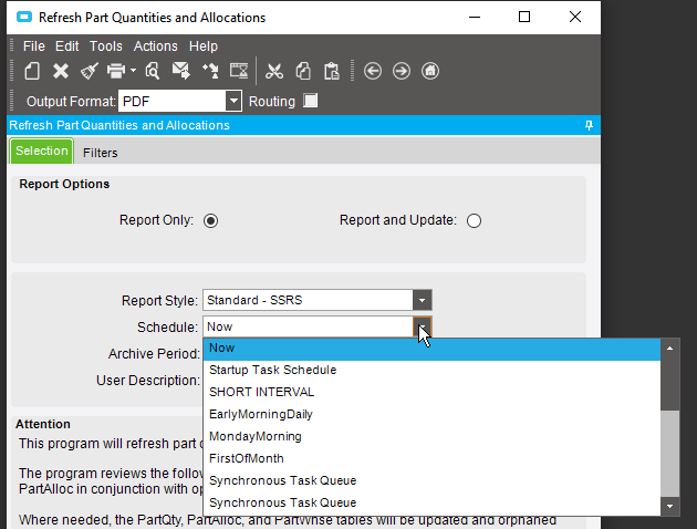

Do you know how to schedule this to run automatically via the system agent scheduling?

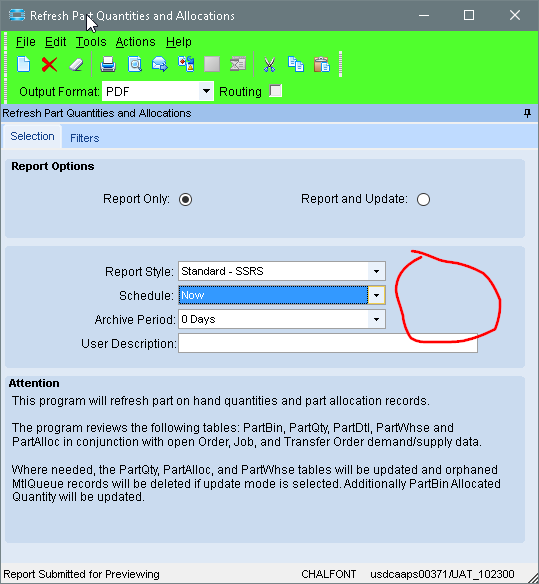

Does anyone know how or if I can Schedule âRefresh Part Quantities and Allocationsâ? Schedule is grayed out when I pull up the menu item.
Do you have schedules in your system to pick?
I do, and I have a couple of tasks already on the schedule.

support told me they intentionally do not allow you to schedule this with a recurring task out of the box. You may need to do a trace, and make a bpm that calls this process on a schedule via changing a ud table field via powershell and rest or by looking into a third party add in called user process scheduler.
That must be new in .300 then, because I didnât do anything to make that available. But Iâm in 10.2.200
Iâm on 10.1.400 and itâs not allowed.
Weâve never been able to run it on a schedule since V8. The reason given is that you cannot guarantee that nobody is in the system at the time of the schedule - which one really shouldnât have anyone in while this is running or you may get spurious results.
That depends on your business hours I guess. We donât run it on a schedule, but Epicor doesnât stop me from putting it on one (the example is in a test system). I donât know what the difference would be between my system and the others were Epicor doesnât let you do it.
This has been for both on-prem and cloud and V8-E10 for me.
This has already been answered I guess, but Report Only versus Report and Update gives different options. You cannot run âReport and Updateâ on a normal schedule like other processes. I just ran it for the first time in quite some time and was looking to add it to all of the other processes we run, but no option. We are a 20x7 shop and I only have small windows to run them. Seems like something Iâll have to run manually once a month or so.
