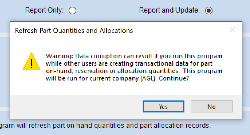

Refresh Part Quantities and Allocations Schedule
It warns you that it could corrupt the data.
In my opinion it’s already corrupt so why not allow us to run it on a schedule. Obviously you need to be smart about when you run it…like the dead of the night.
I plan on trying to piggy backing off another scheduled process in a Post Process BPM to basically run it from there. I don’t want to filter so I just need to get the defaults, mark it to report and update and submit it to the agent.

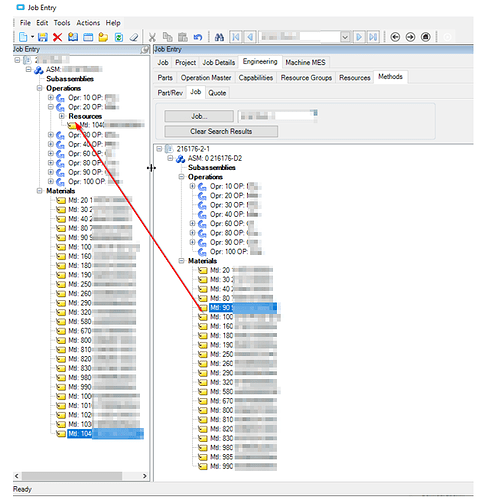

We have found something. If you add materials to a job from another job as a template it does not update the part demand (screen shot to illustrate what I’m on about)
This is replicable and has been reported to EPICOR

Meanwhile I replicated our issue on the demo database and am waiting for EPICOR to comment. The job that is used to drag materials from can be any job, not just a template job. And also if you follow these steps and then remove the added material / edit quantities etc. all sorts of strange things start to happen.
