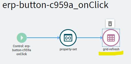

Anyone know how to use grid-refresh? I’m trying to refresh a grid after I’ve updated it but I can’t seem to get it working.
The value is ["grdSelected"] - Includes from the Data Model → Grid ID
But it doesn’t work ![]()

Alright, think I figured it out.
It is not looking at the ID here
It is looking for the ID here (I generated a GUID)
Then…

I had to assign my grids an ID as they didn’t have one but once I did worked like a champ! I didn’t even have to use a GUID.
