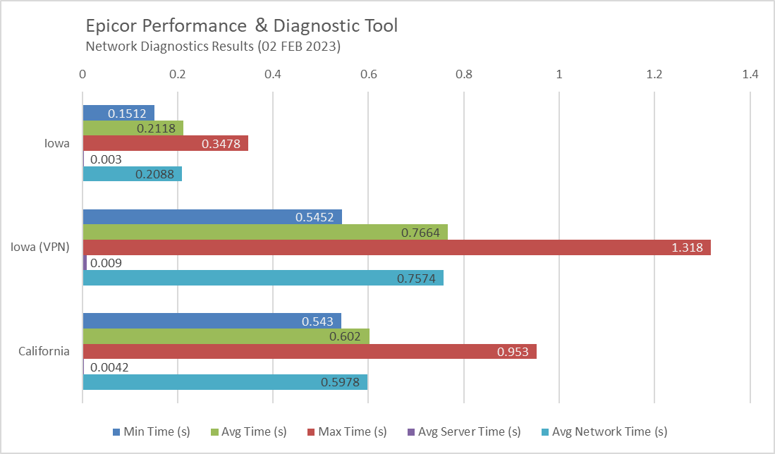

Have you run the Epicor Performance Diagnostics tool from that remote location? Itâs part of your installation on the server and Support will want you to run that.

Thanks Mike. Lots of variables, itâs hard to determine where to start, but it sounds like running the PDT is a good first step. I thought it was intended to be run on the App Server itself, not from remote clients, but I will run it and see where I go from there.

With the PDT, you want to be looking at the Network Test, which downloads a set amount of data from the server using your client protocol, and is a test really designed to only be run from a client (the number of times people seem to run it on their server as if to prove something beggars belief).
So install the PDT on a client on your LAN, run the test and then compare with a client at the remote location.
Also, I canât see what your main site version is, and which protocol you are using - https may work better over a WAN than Net.tcp (this can be tested with the PDT Network Test tool).
