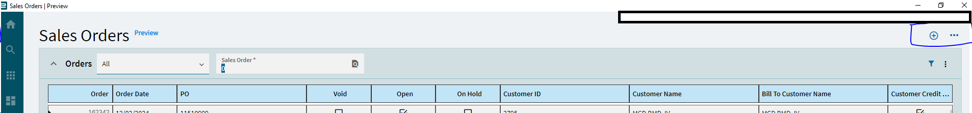

How do I remove/Disable this new button form the screen?? . Please see image-

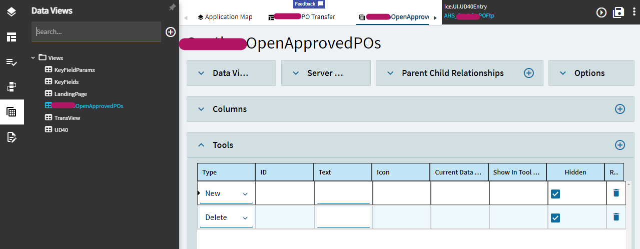

This one drove me crazy on a UD screen that I was making.
I had to first create the New tool in the DataView, and then Hide it:
For the Sales Orders screen you will probably need to update the OrderHed DataView.

Yes I have tried adding the New tool and making it hidden in the OrderHed DataView.

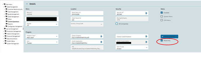

I needed the readonly version of sales order entry. and the Add (+) button was in the way of that.
So what I did was, made the screen readonly when I added the screen to a menu item by checking the tick here in the image
. And that made the whole screen readonly and got rid of the add button and other buttons that might edit the screen
