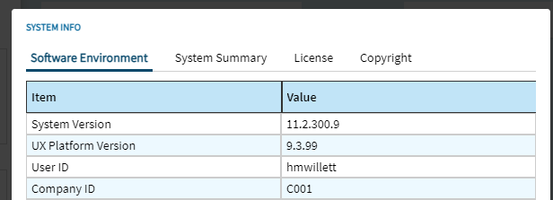

I am on
Version:
11.2.300.9
UX Platform Version:

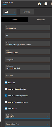

Are your buttons added as action data on the form?
Mine is:
11.2.400.3
10.1.33

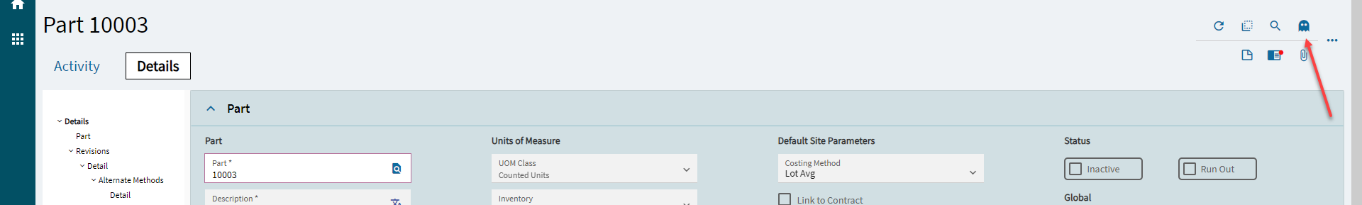

Come on. You think I’m basic??! (Yes, they are. :slight_smile: )
Ghost be ghostin’ just fine.
Thanks for checking. Per usual, i find issues unique to myself haha. I will investigate to try to narrow down the issue.
I notice your button is on the top row, while mine are on the bottom row.
I doubt location is the issue, but that seems to be a result of App Studio being App Studio.
Deploying it to the menu apparently flips it to the top row. :upside_down_face:

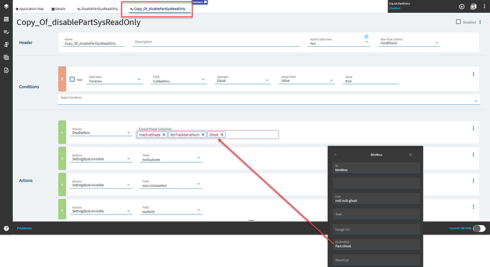

Did you create any row rules around them?
Or, just try and circumvent the issue and bind your button, create a copy of their SysReadOnly rule and exclude the button binding. :woman_shrugging:t2:
Sounds like a plan! I have the rule copied. How do I override the system one?

I see now that I used a different method for my buttons. I actually added them to the main page’s tool bar.

I noticed in some screens Epicor has had logic that handles read-only on trackers as disable all except these columns. That has included my custom bound buttons. What dataview are your buttons attached to and what kind of row rule is in place for the disable. I ran into this problem in Posted Invoice Update
I am bound to Part.toolPrintSkid for one. Following Hannah’s advice, I copied the system rule for ReadOnly trying to exclude that field. No luck.
Ok, so I will have to go back up and mark Hannah’s answer as the solution. Though I copied the row rule as requested, I just noticed it was disabled by default…groan.

Double check that row rule. It wasnt immediately obvious to me that it wasnt enabled because the state of the screen didnt quite jive with my brain (aka the checkbox is for disabled, not enabled). Would be great if they had a row rule to make that red when disabled haha.
Also, I guess you need to make sure your Action view in your rule is the same as the binding view of your control you are trying to affect.
