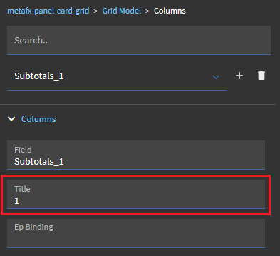

Is it possible to rename grid column header programmatically, preferably with variables? I have a need to rename the resulting BAQ grid column names dynamically with dates like “MMMdd”. In the classic dashboard, a simple 2 line customization was used to do this.

I check in few event widgets like event-column, event-view, dataview-xxx but didn’t see any way.
Oh well, back to the drawing board. I’ll probably have to resort to creating an event to call function to call a sp to return a ready-to-use table. Can you think of other ways?
