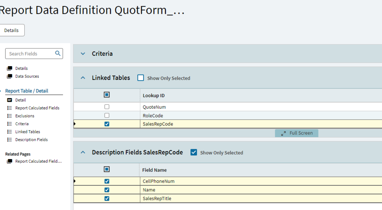

I am trying to create an SSRS report that uses information from the QSalesRP table, but there are certain fields that I want that seem to be missing.
Can I add these in somehow? Or do I need to create a new table? The fields I want are the sales rep’s mobile phone number and job title.
Any help would be great.

The information you need to get to is held on the SalesRep table.

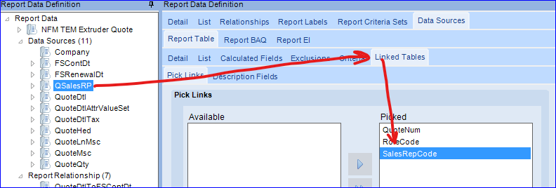

Depending on the RDD you’re working with, the SalesRep table may be there… or available as a linked table on the QSalesRP table.

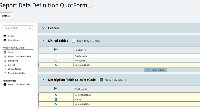

For example, on QuotForm (RDD) QSalesRP has a Linked Table called SalesRepCode (not sure why they can’t just use system table names?).

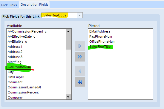

That will get you to things like CellPhoneNumber & Titale fields.

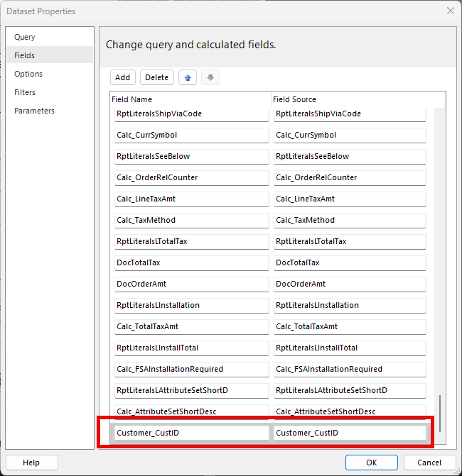

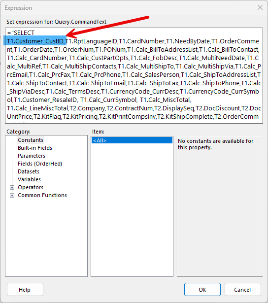

Keep in mind, you’ll also have to add any fields you need to your RDL query as well.
If you use a linked table… you’ll have to see how QSalesRP is joined into the query. For example, if it is joined as T5, then adding the linked table field would look like:
T5.SalesRepCode_CellPhoneNumber
  • T5 represents QSalesRP
  • SalesRepCode is the linked table
  • _CellPhoneNumber is the field from the linked table.

@dcamlin Thanks for this. I think I have added the fields from the linked table

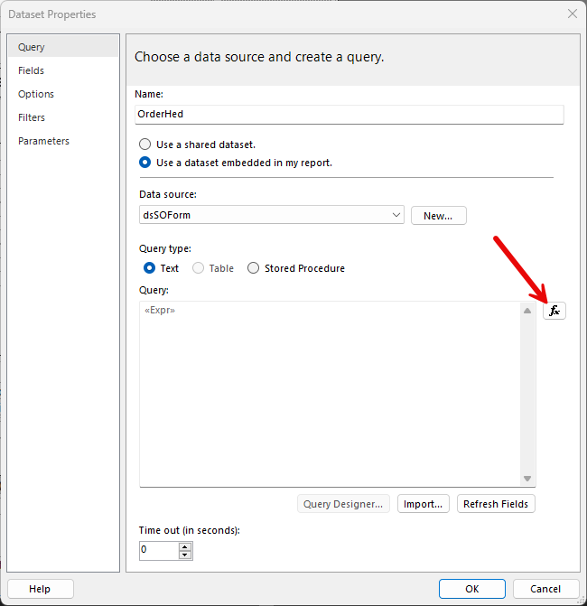

Do I edit the RDL query in Microsoft Report Builder?
yup.
The benefit of using linked tables is that you don’t have to add a new JOIN to your RDL query (in Report Builder). You just have to add the new field references to the query.
Oh, and add them AS query fields as well.
