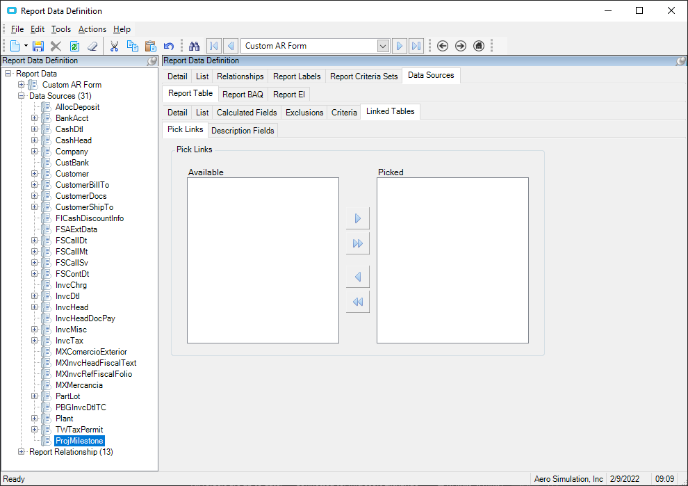

I’m working on modifying the ARForm Data Definition for a report. I need to add a column but I’m struggling with the relationships between this table and the existing DD. ARForm uses many calculated fields, and I’m wondering if there is a way to pull a DD into a BAQ to see the relationships? Otherwise as a newb to Epicor, not knowing the data model, I’m not sure how I’ll accomplish as much as I’d like. I sincerely appreciate your input and assistance!

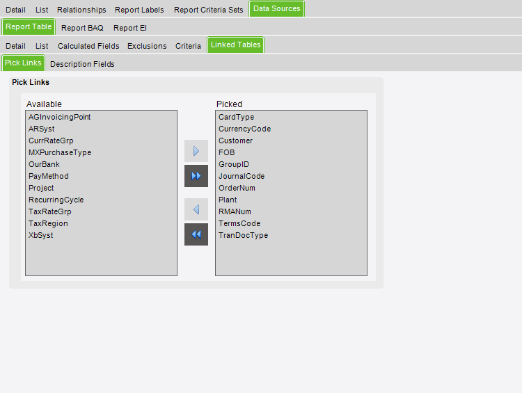

If the table that you want is not already listed as a Data Source, always check the Linked Tables to see if you can access it there. If you can, use that functionality instead of reinventing the wheel. Let us know if you have any more questions.
It doesn’t have any listing. I’m adding ProjectMilestone. Any ideas?

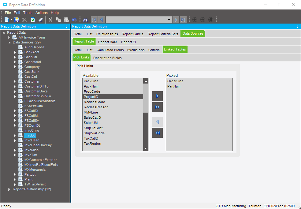

You need to check the existing tables in the system RDD to see if the table you need is already hung off of one of them. As an example, you can select ProjectID from InvcDtl.

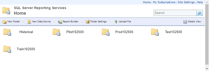

Do you have access to the Report Server?
Yes. Thanks for the pointer, I’ll see how far I can get.

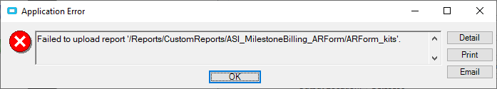

So I’ve changed the RDD, and the RDL in SSRS, the SQL in the RDL, added the needed fields etc. Successfully saved the modifications, now when I try to execute the report I get nothing. Epicor doesn’t even show the attempt in the System Monitor. :confounded:
Answer this… So I added a table to the RDD, I see the Relationships tab with 5 calculated fields, I suppose I need to do some type of calculated field for the Project ID within the ProjectMilestone table to connect it in the RDD to InvcDtl?

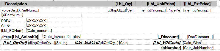

I need to add ProjectMilestone to the ARForm standard report. I’m adding ProjectMilestone.Description to include it under what had the header of “LinePart Number/Description”. I see the “Linked Tables” tab recognizes the relationship between InvcDtl and ProjectMilestone. I’ve removed the Excluded Checkbox for the Description field within ProjectMilestone in the RDD. Screenshot below of my RDL changes. To further clarify the “[XPartNum…]” box does have the second ProjectMilestone.Description in it, but the name hasn’t changed.
