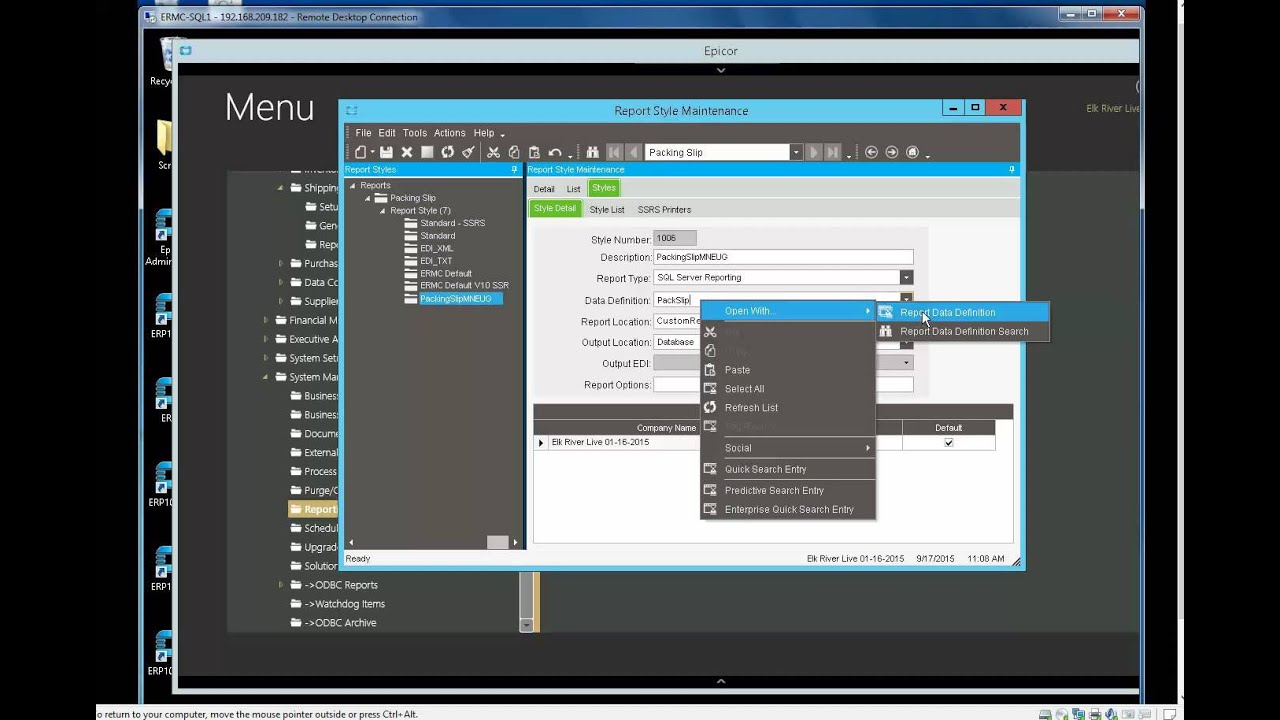

  1. Opened Report Data Definition, opened QuotForm (not a typo on my part, the system report is spelled this way), Actions - Duplicate Report. Added New Table (my UD01). Clicked on my new table (in the tree view) then went to Data Sources, Report Table, Exclusion, and unchecked the fields I wanted to use on my form (about 10 of them). Then I added a New Relationship to tie the QuoteDtl table to the keys in my UD01 table. (My pictures were not taken in sequence order)

  1. Opened Report Style and found the standard QuotForm. Clicked on Standard SSRS in tree view, then Action - Copy Report Style. On my new report Style, I change the name, and select my customized Report Data Definition as the “Data Definition” on the Report Style - Styles, Style Detail - Details tab.
    Then in Report Style, went to Action - Download SSRS Report. When I open the QuotForm.rdl file, I could not see the fields I want from my UD01 so that I can update my SSRS Quote Form.

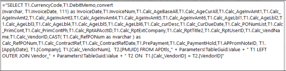

In the Report Builder, right click the datasource and select properties. There you have access to the entire query. You’ll have to add fields to the select portion, and possibly add a join clause to include the new table(s).
Then you’ll need to add the Query fields so they show up in the tree on the left. This is also done in the datasource properties, under the fields tab (I think?)

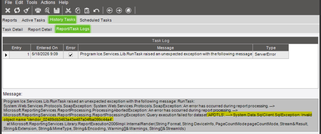

Hi, I try to add the Payment method field on APAgng RDD as we duplicate the original RDD and add the relationship for vendor to fetch PMUID. Everything is fine but in rdl file i am facing the problem like “Invalid object name Vendor”. Attachment for your reference. Please reply!!
