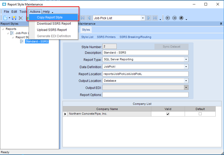

The next step is to Copy Report Style in Report Style Maintenance. This will create the SSRS report in the Custom Reports folder that you are looking for.
You should have left the RDD as type Base Definition.
Then in Report Style, dup it like @bmgarver said, and change then RDD to be the one you created. The RDL you want to edit is in the custom reports folder

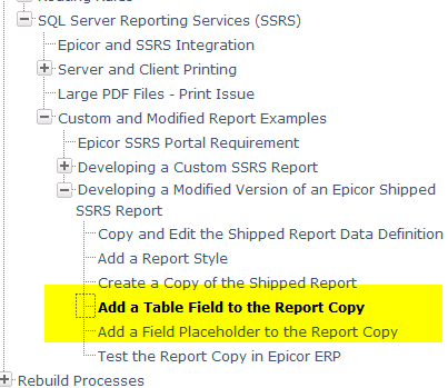

Search the online help for “Developing a Modified Version of an Epicor Shipped SSRS Report” It’s a step by step example.
Specifically:

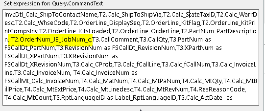

I added the OrderHed table to the ARForm RDD, to include two UD fields (JE_JobNum_c and JE_CustNum_c) and only had to make the following changes to the report:
  1. Update the ARForm dataset expression, inserting the following:
I don’t recall how I knew to use T2 instead of T1.
  1. Add the fields…
