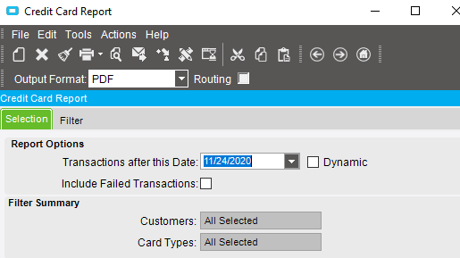

I am needing to modify report parameters for a standard epicor report to include a date parameter to include between two selected dates. I have duplicated the standard report and created a new report style and data definition for the duplicated report. I just need guidance on modifying the report window when running the report to include new date parameters.
Which built-in report are you trying to modify?
Credit Card Transaction
I need to have the parameters be a date in between two dates instead of the default greater than date and/or dynamic selection parameters.

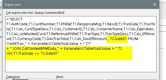

Try the following:
- Customize the Credit Card Report form, adding a date control. Bind it to
CallContextBPMData.Date01 - Nothing need to be done in the RDD
- In the copy of your CC Report RDL, edit the Query expression for dataset CreditTran. Add the highlighted parts below:
The RDD will use the native date from the form to limit the lower (oldest date), and the additions to the Query expression limit the upper end date.

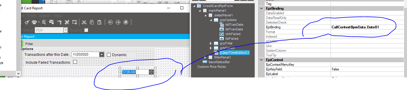

I appreciate the help, so I’ve added the parameter code and updated the rdd file, uploaded the new report into the report style, and now I’m customizing the report form and binding the new parameter such as below. Is that correct? New to Epicor so appreciate the help. Running the report is resulting in a blank report.
That control.you added to the customization needs to be a date editor, not a time editor.
Other than that it looks good so far.
One note, you will get a blank report if you don’t enter a date in that field when it’s run.

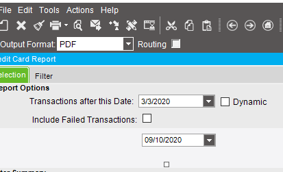

I’ve adjusted the control to a date editor, however, I am getting a blank report.
Have you tried other dates in the custom field (like far in the future, and far in the past)? Same thing if it is blank?

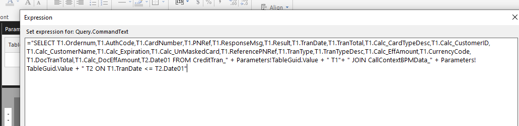

Can you post the query expression from the RDL?
Yes, still getting blanks. Below is the query expression.

The FROM part of the expression should be:
FROM CreditTran_" + Parameters!TableGuid.Value + " T1"
+ " JOIN CallContextBPMData_" + Parameters!TableGuid.Value + " T2
ON T1.TranDate <= T2.Date01"
I think you have an * where a + should be
Try changing " JOIN CallContextBPMData_" to " INNER JOIN CallContextBPMData_".
If you get the same thing (no results), then try
" LEFT JOIN CallContextBPMData_"
That should make it so that the BPM data doesn’t limit the data used by the RDL. The report should look like it normally would (just using the Trans after Date parameter). If that renders okay, add field for T2.Date01 to the report body, to see what appears when it runs.
