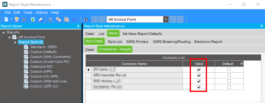

We saw the same behavior finally realized that the Valid checkbox had been cleared for all report styles on custom reports. Checking the style as valid for the company made it show up in the dropdown again.
The valid path also doesn’t come over when you load reports using the Solution Manager. Just went live and took all our custom elements, including new Report Styles to our LIVE system with the Solution Manager. I had a dashboard showing me all non-System Report Styles as one of my post-upgrade tasks was to click Valid and Default on a lot of report styles.

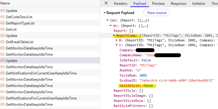

Does anybody know how to query or UBAQ ReportComp.ValidStyle? I don’t see a table by that name.
Perhaps ReportSvc is the only way?
I believe it’s the CompanyList column on the Ice.ReportStyle table. When you create the report style it assigns to a company and that one is included by default and then checking the boxes for others will build out a tilde delimited list in the CompanyList column.
