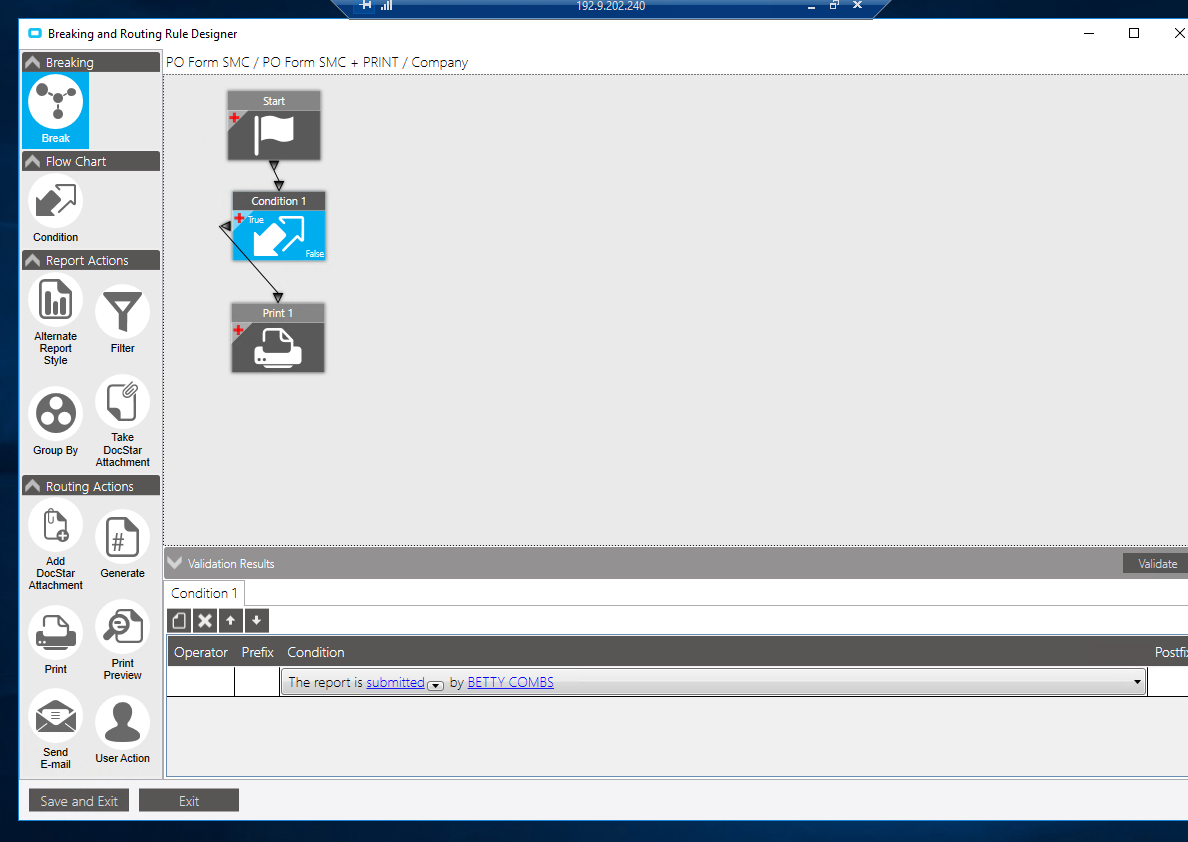

Im trying to perform 2 print actions on Break/Routing in Report Style Maintenance. I am breaking on company, then print preview so the PO can be saved and also send it to a separate printer that is currently set up to hold the print until the user goes to the printer and picks it up.
I can select “print preview” when I go to print the po and it does send it to the correct printer based on user so it will hold the print, but the print preview does not show up in pdf form so I can save it at the same time.
Any suggestions.
A break routing will ignore the user selected “ouput” (Print, Preview, Email, etc…), and do the output selected by the widget. The exception being, when the “User Action” widget is used.
Place a Print Preview widget between “Condition 1” and “Print 1”.
Also, pretty sure you need a Break Widget.

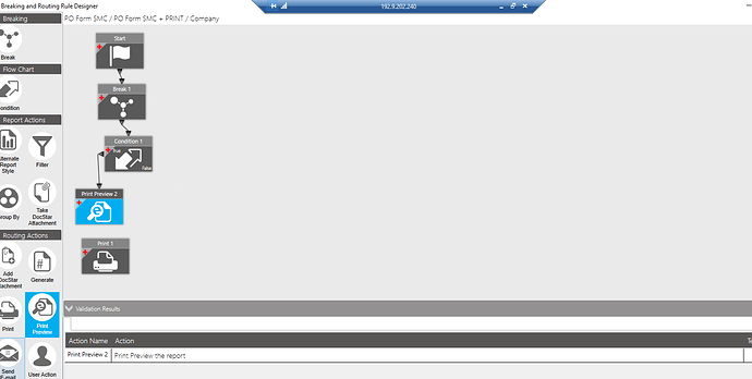

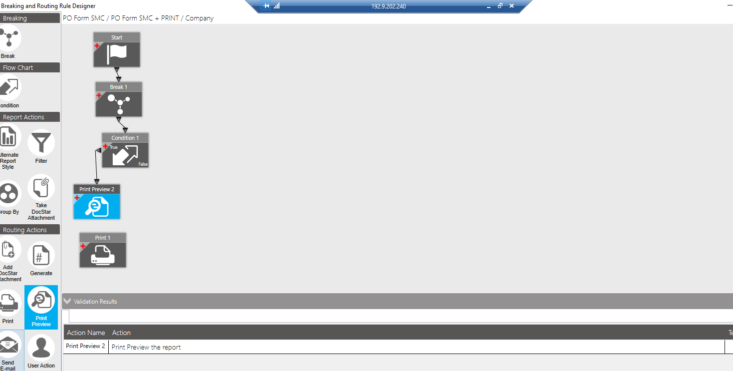

Thanks! I added the break on company, added print preview but it wont let me link preview 2 to Print 1. Would I need to add another condition ??

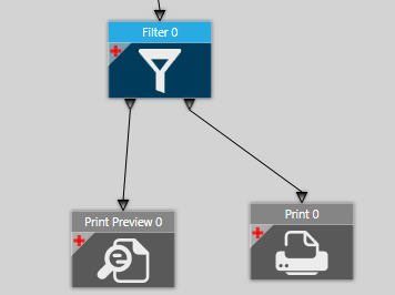

After your condition you should be able to add a node that has multiple outputs (like filter or break) and send it to both print and preview.
What Carson said.
Thanks! that did the trick!
