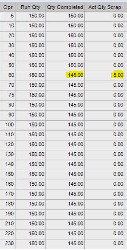

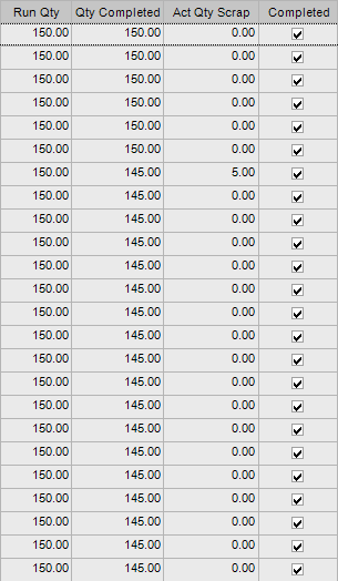

Yes. This was a make to stock order. On each operation I marked it complete, at first I didn’t have to as my qty completed matched the run qty. After the operation where I scrapped 5 out of the 150 I manually had to complete each operation:
I cannot receive any more off of this job. I get the “The Quantity entered exceeds the quantity completed for the job” dialog box, yet I still have WIP on this job. The scrapped quantity does show on the Job Production Detail Report. I’m not sure how to find out (if I can) what the system thinks is stuck in WIP.
