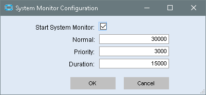

Any chance the Sys Monitor configuration got changed?
The default is:
(use Actions -> Configurations menu to get that dialog)

We expanded the duration to 30000 in 9 and I think i may have seen a 90000 recommendation in a KB.
The reason from Epicor was if you missed at 16 seconds it would be 45 before it was pulled. I was coming off of telnet that printed in less than 5 seconds, so the users were cranky.

My configuration matches your settings.
I changed my settings and it worked, I do run into issues with printing at work and on VPN. Hopefully that’s in the past.

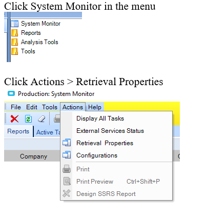

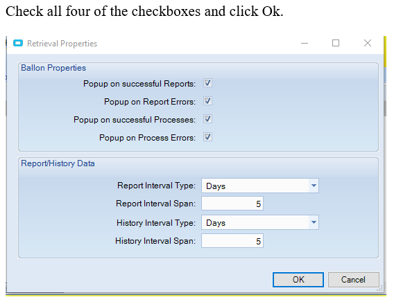

Not without pushing new config files out to everyone. We made a doc to set the Balloon properties so all users would know when they had a report with no records. I would do this the same way and walk them thru it.
