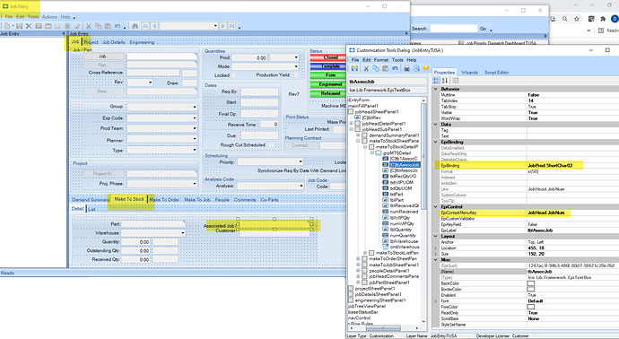

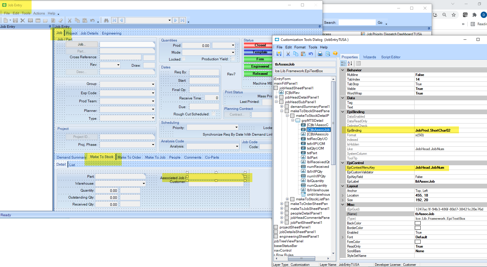

Hi Anders,
See below screenshot for details.
We have link to JobProd.ShortChar02 (and 01 for customer notation). They also like to write “stock” in SC02 if the job is to satisfy Safety Stock. I also have placed the fields on the job traveler, pick list, and a job priority dashboard. If you are on-premise getting the UD fields in there just requires a downtime to get the data model regenerated. If you are SAAS, IDK how you get those on there, but I’m sure other experts here do!
Note, on the JobProd there is a “make to job” option that we have failed to use well in our company to date. I believe our biggest problem has been with accounting on it, that cost of supply job is not right unless job financially closed and then adjustments necessary when all labor charges/materials entered on supply job :weary:. (I really would like to do more testing with this.) So for us, make to stock so far unless it’s a make to order.

Hi Anders,
The planner does it manually when they firm or create the job. At this time, they generally know why they are cutting the job and it’s a good time to note it.
I have the EpiContextMenuKey as JobHead.JobNum to provide right click “open with” job search if they want to search for a job to associate. Also, have a bpm that fills in customer name from associated job if job entered is a make to order one.
