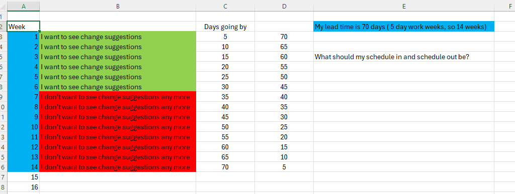

To clarify my 2 questions the issue is the following example. They buy from China and if they make a mistake of need to push out a order they still have 6 weeks to notify China they want it held. After that no changes can be made as the product is on the water. I pretty much was sure that this could not be done. Technically with what they want the delta would then have to be 0 so they can see the change suggestions. Am I right?
what you are describing is a time fence I believe, but it is in reverse… you specify that the time fence is 6 weeks (today + 42 days). Anything after the time fence is available to be rescheduled, but anything inside the time fence is eliminated from any suggestions.

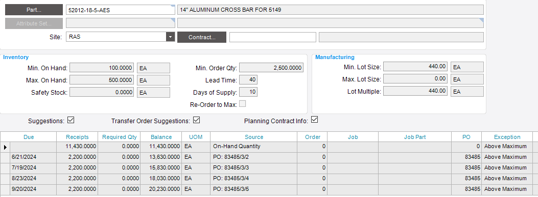

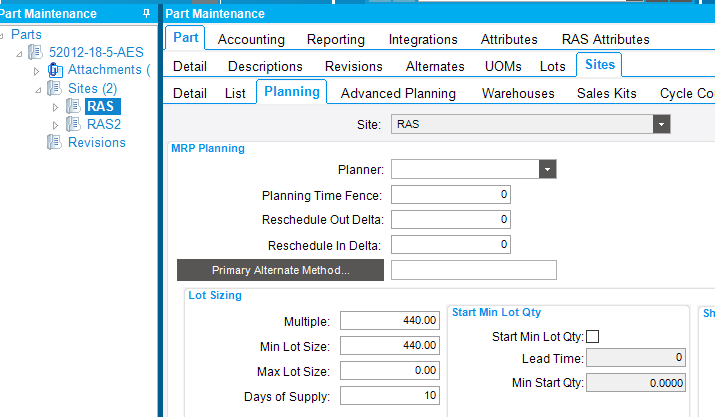

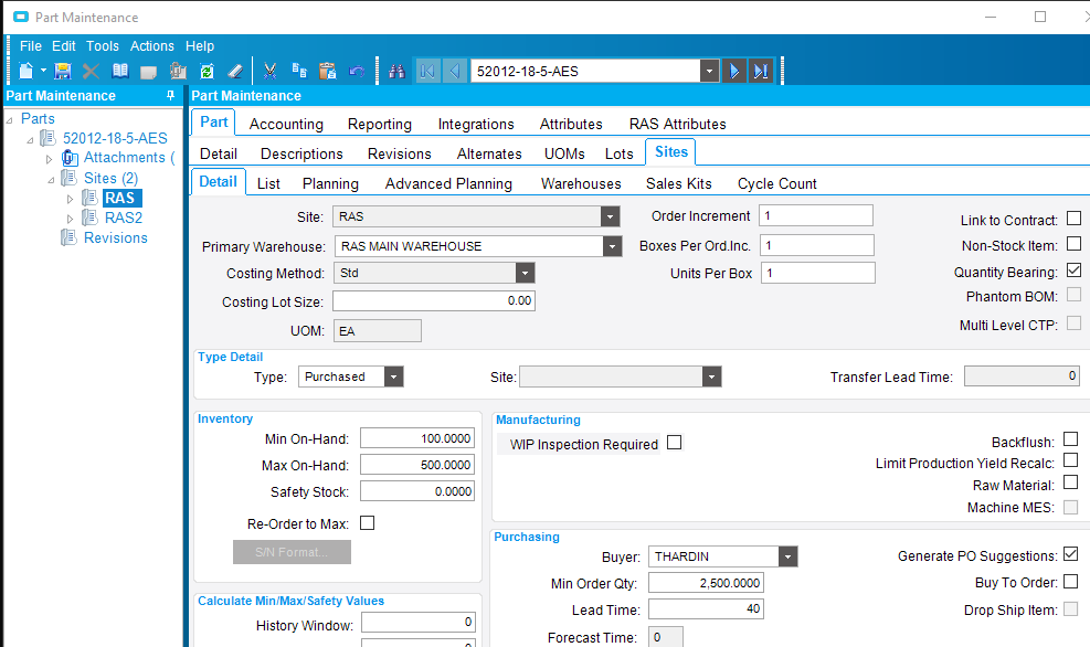

I have an example of where I expect PO change suggestions to be to cancel all these PO’s and nothing is being generated in the buyer’s workbench telling her that……any clues where the problem is. We have another plant that is generating changes suggestion properly and I haven’t found any setting different yet between the two plants. I purposely went in and 0 out the planning delta’s. Ran MRP for the part and then regen PO suggestions for the part and nothing. We have a full run for both tonight and I plant to look again tomorrow just in case the net change might be the issue since I only ran that one part.
