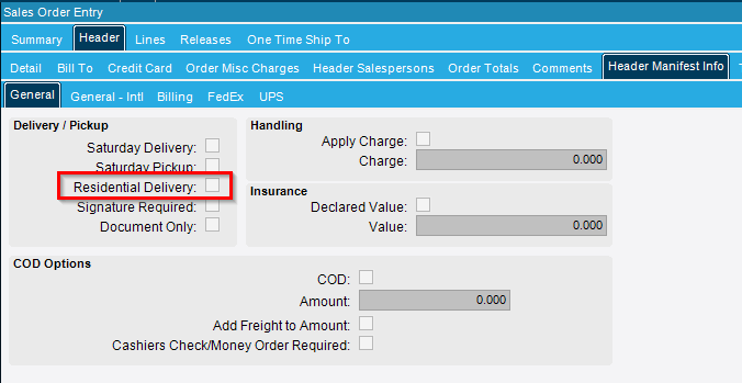

Does anyone know of a way to have Quick Ship validate the ship-to address on an order and automatically check the residential box if it’s a residential address? Ideally without creating a BPM or API. Thanks!

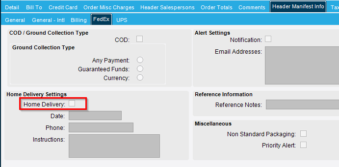

You’ll need to do a customization/bpm. We use the FedEx API to return commercial/non-commercial on the address for Manifest (old Quick Ship).

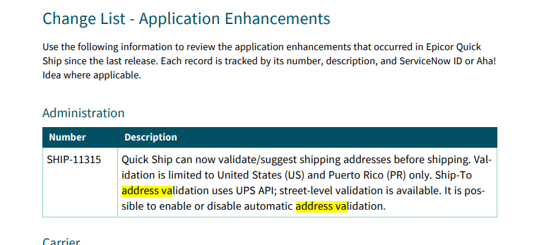

Thank you. I am surprised this isn’t standard Quickship functionality. If you or anyone else thinks that residential address verification should be standard functionality in Kinetic/Quickship, please vote on my Epicor Idea # QS-I-158.
Thank you @Devin.Draeger. The only issue is that it doesn’t tell the user if the address is residential. In my opinion, that should be part of the standard address validation process - to automatically check the residential box for the user if the address is classified as residential per the UPS API.
@askulte - what exactly does your BPM do on the Kinetic/Quickship side when it identifies a ship-to address as residential?
