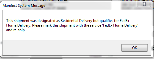

My shipping team is getting an Residential Error in Epicor on certain customers. What would be causing this?

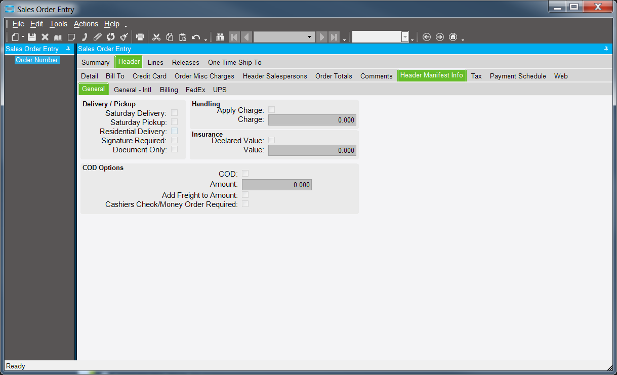

On your Order in your Delivery / Pickup pane:

This message is probably coming from Manifest/Insight. It’s nice that they do this. If you don’t tell UPS that a shipment is residential, they charge you extra. They route residential deliveries after business deliveries for the same service level.

That is quite possible William. Manifest may have passed the address to FedEx to validate and FedEx knows that it was residential. The important part is to mark residential addresses as residential.

But, it will not let us ship unless we uncheck the box-Just asked my shipping supervisor.

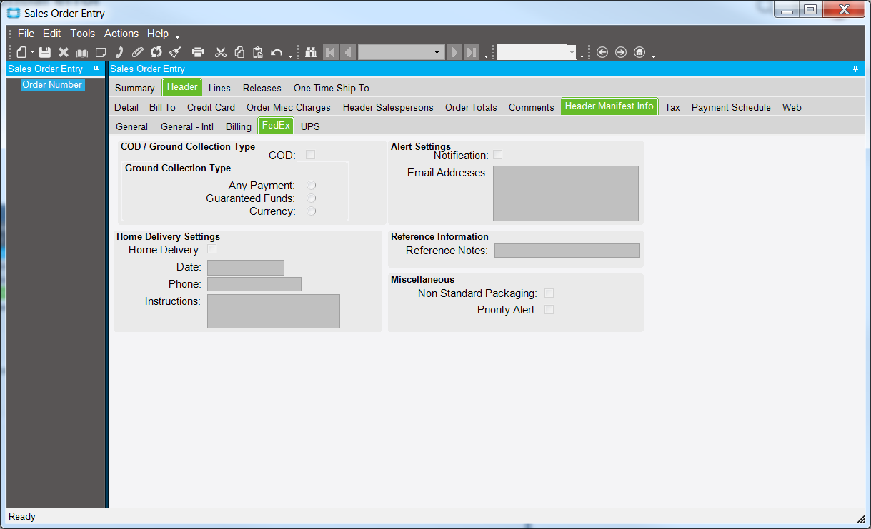

In this case, the way to indicate it to FedEx is the Shipping Method: FedEx Home Delivery, as they suggested. I worked more with the UPS interface and the Residential Flag was important. FedEx seems different for some reason.
