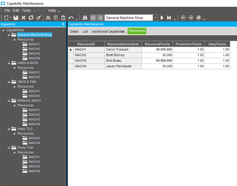

You might want to look at the capabilities settings.
Capability Maintenance
Use Capability Maintenance to define capabilities that are available within
your production facility. For example, capabilities could be shearing,
turning, setting, painting, drilling, and so on. The capability is then
associated with resources for scheduling purposes.
Important: The ability to set up Capabilities in the Epicor application is
only available if you have the license for Advanced Planning and Scheduling
installed.
Following is a diagram that illustrates the relationship between
capabilities and resources/resource groups:
Menu Path
Navigate to this program from the Main Menu:
