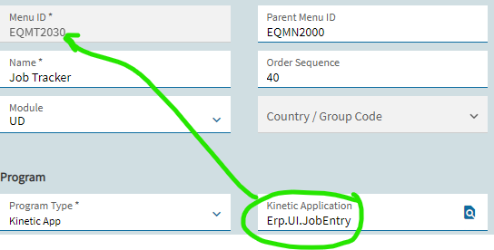

As @dr_dan mentioned, it is opening MenuID EQMT2030.
The Event in Kinetic is actually targeting Erp.UI.JobEntry (which is correct).
Here’s menu maintenance:
Both Job Entry and Job Trackers use the Erp.UI.JobEntry application.

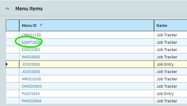

I THOUGHT, perhaps it was defaulting to the first menu alphabetically… but that doesn’t seem to be true either, as the first Tracker menu is CRMG1150.

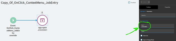

To Fix, in App Studio, create a new layer (if you don’t have one) and Copy the

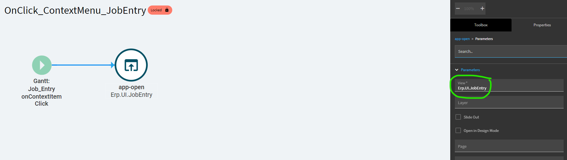

OnClick_ContextMenu_JobEntry event.
The base event is calling the app-open… and targeting Erp.UI.JobEntry… which again, is technically correct. WHY its opening a tracker menu by default, I have no clue.
In your new “copied” event… change your trigger to:
Event
Override
(if you’re on an earlier version and don’t have the “override” option, we’ll have to explore other methods to pull this off)
Then in the app-open… instead of calling the APPLICATION… you can instead put in a specific menu ID. So I set mine to JCGO3001
Now, when I click the context menu, my event calls JCGO3001
… which is a true Job Entry menu, not a Job Tracker.
