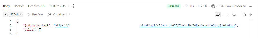

I am trying to use TokenService to get a bearer token, at the moment just using Postman to test
I just use a Get on
https:/<instance>/api/v2/odata/OFB/Ice.Lib.TokenServiceSvc
but this is all I receive in the response
I am doing this call with Basic Auth
Can you explain how you are using TokenService ?
