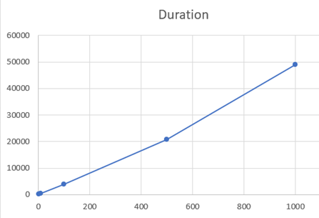

Returning data seems extremely slow, should I open a support ticket? Or a new topic here? Or is there some dumb newbie mistake I should have found in the docs?
This is duration in ms versus number of records. Of course, we shouldn’t need ETQ to return the whole Parts table every time, but it still seems slow:
Any thoughts?
Create BAQ instead
Or a function, depending.
agree to both…but this is for an integration with ETQ. “Give me all your parts”, they said. “We’ll be gentle”, they said.
And that being said, 30,000 parts in JSON appears to be 30 MB - should download in seconds, not hours. Or am I missing something?
Or, do you mean use BAQsvc even to return “all parts”?
BAQ is going to be faster. The BO has more overhead, paging, and other stuff I don’t understand.
I agree with @olga and @klincecum. In a BAQ, you can also limit the columns that ETQ actually needs - reducing the size significantly.
And sure enough, 30,000 records is less than 2 seconds. Thank you all!
