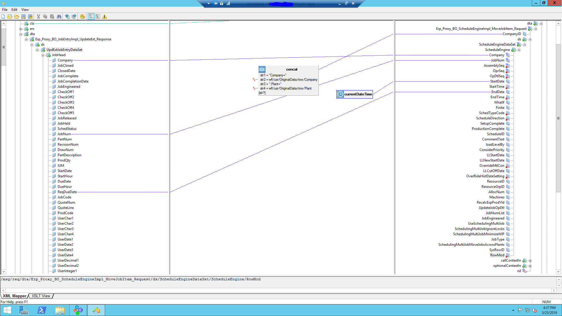

I used a workflow as the blueprint for the web page. This is the what the conversion that schedules the job in the workflow looks like:

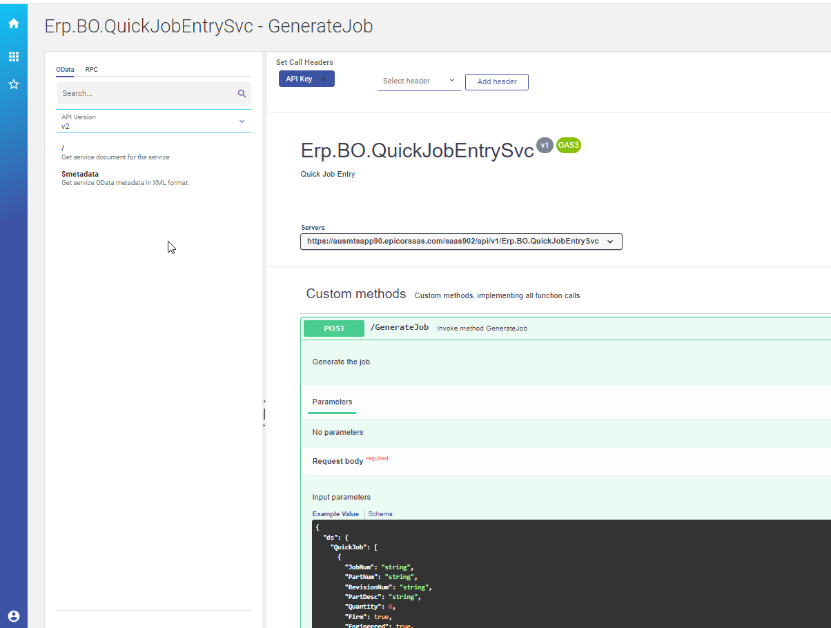

Hi, I am working on something similar to this and was just wondering if you could post the JSON for creating the job. Would really help, thank you.
best way to get this is to do it yourself… that way you will get the correct version of the schema for YOUR system.
The domain name yourservername.com is for sale | Dan.com will take you to the rest help page. once there, you find the API you want to work with. For example, I went and searched for the QuickJob entry (the easiest way to create a job) and saw this screen… below the screen is the JSON that I copied.
