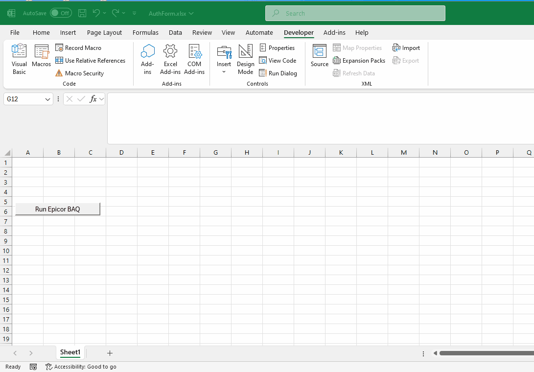

:nauseated_face: Just because you can… doens’t mean you should. This uses an embeded browser in the workbook. And a macro to do the leg work… But I must say this is pretty gross, I’m 99% sure there isn’t another way to do it in VBA because its so out-dated.
Requires a Custom Form within the VBA Excel Macro with an embeded browser becaue you need to go to the browser and follow redirects etc to grab the Authorization Code
VBA
AuthForm.xlsm (26.1 KB)
Here’s the VBA Code
