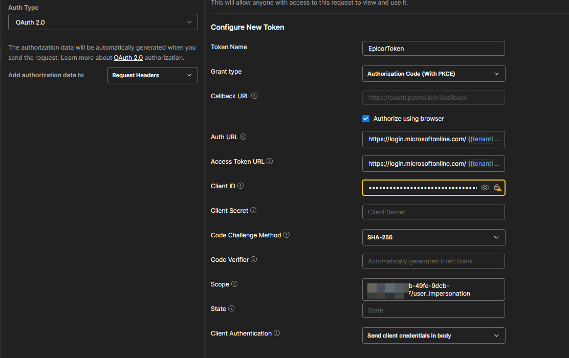

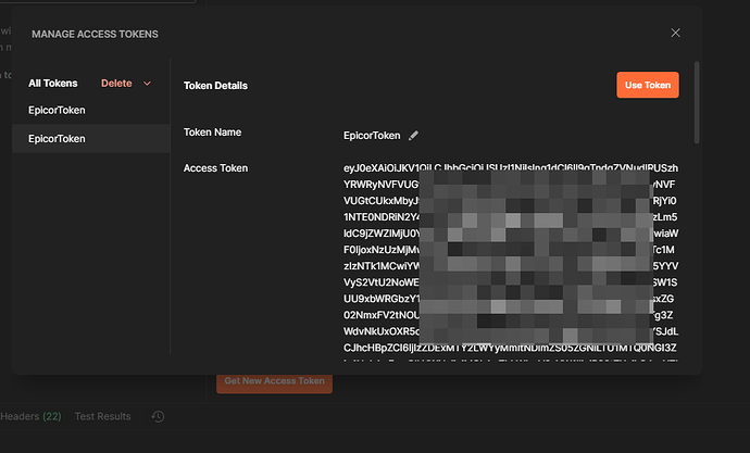

I feel like I am getting closer on this but I need some advice. I have been able to get a SSO token from our server using OAuth 2 (client id, secret, etc). I am using the client information set up for our Epicor SSO client.
My question is now how do I apply that to get the REST API calls to work? I have tried running the call with the bearer token generated but that doesn’t work. I have tried to get a token using GetAccessToken with the generated token and that does not work either. No matter what I try I get the error: IDX10231: Audience validation failed.
I am working on all this is Postman just to figure out the proper sequence of calls.

You need to give it the scope of user_impersonation Grab the ID from here
That needs to be passed in the the scopes array
Then you need to make a request to Azure to aquire a token using that scope (after you receive the auth token)
Then you’ll get back an accessToken which you can use as your Bearer token on subsequent epicor requests.
So depending on what you are doing it should go something like this note that the scope is an array…

POST https://login.microsoftonline.com/{tenantId}/oauth2/v2.0/token
Content-Type: application/x-www-form-urlencoded
client_id={clientId}
&grant_type=refresh_token
&refresh_token={refreshToken}
&scope={scopes}
Just tested it on Postman works great.

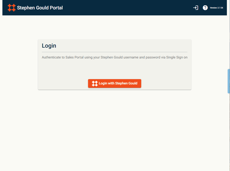

If you are using Azure then this is what you want. The user does need to enter username / password if they aren’t already authenticated to Azure. If they are, it will be just seemless.
Here’s what that looks like 99% of the time
SSO
But if the user is somehow not Authenticated already to Azure then they’ll be re-directed there. Like this
SSO_NotLoggedIN
