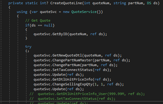

I am currently creating quotes with REST API. Every thing works like a charm from creating QuoteHed to Creating Quote line, quantities, etc. Although, I can’t figure why the Quote Line Unit Price is not Updating. No error, no nothing. The Tracing Options is telling me to use GetDtlUnitPriceInfo_User.
image .
Here is my code for the method:
I have a plan B witch is to call and updatable BAQ(not tested via REST) but it works through the BAQ Designer. I would really not prefer to go there. Can somebody help me out!

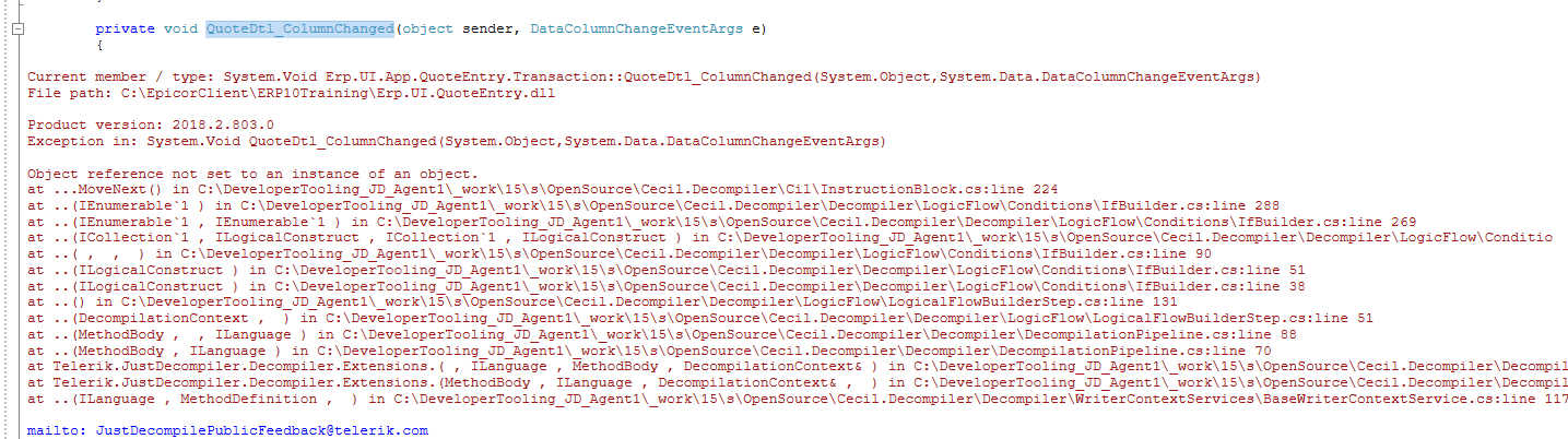

I’ve tried the fields you’ve mentionned in my tests (should have mentionned it) and it did not work. I’ve also tried to look what the UI does in the Column_Changed with the dsp field and JustDecompile is giving a bunch of scrap.
IL Spy is not much of a help neither.
The HttpRequestMessage is using a Post method. The Get method you see are reflection method of the current method. I’m using the same approach for all my methods. I have attached the Json object. You’ll notice there is alot of price fields set to 888.0.
I’ve just noticed there is an error returned by the server (500). The Epicor App server says nothing (in the event viewer).

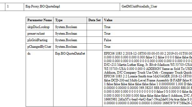

I’ve called the GetDtlUnitPriceInfo_User from REST and from the UI and they do not give the same Json. The call from UI is updating QuoteHed while REST doesn’t. QuoteDtl seems to be the same.
I join the two files.JsonObjects.zip (11.4 KB). (VisualStudio = REST)
As stated previously, I’m updating DocDspExpUnitPrice in both calls (from UI and REST). I don’t have access to Column_Changed (DocDspExpUnitPrice) with a decompiler. So, I don’t know what’s going on.

Did you do a trace? And update all the fields that change?
Jose, Thanks for your response.
Here’s what’s going on. I execute this portion (following the trace option sequence)
It creates a quote line plus quantities. Then I go in the UI and I enter the unit price. It raises the
and the Update
When I execute my code entirely, all the fields your seeing above (from trace option) have the same values in the json (QuoteDtl) prior calling the update (FromREST.zip (5.8 KB)) .
