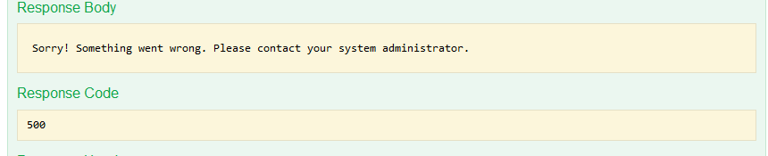

I went into the swagger > Bo.QuoteSvc/GetNewQuoteHed section and found the example. I copy pasted it into my POSTMAN and tried to run it, but I’m getting a something went wrong Server 500 error.
I can run other REST requests inside my POSTMAN so it must be something with this particular service. Is there some way to find out what the error was? Maybe a log somewhere?

I think I accidentally edited my first post instead of replied, anyhow I’m looking for a way to find any logs for “Something Went Wrong” server 500 errors. Are those logged anywhere? Maybe IIS? I wouldn’t even know where to look for that though.

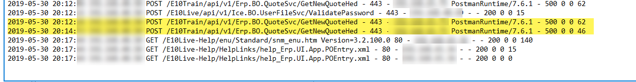

I found the IIS logs, but they’re not really detailed. I found my failed POSTMAN requests along with the POSTMAN requests for other items that successed (status: 200)

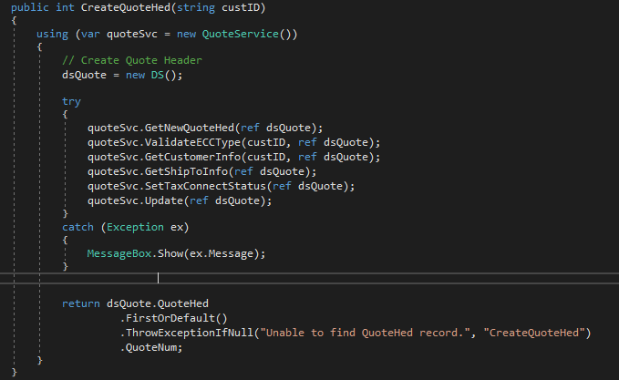

I understand you have done a GetNew and an Update. I don’t know if you have done a trace…as suggested multiple times by different member.

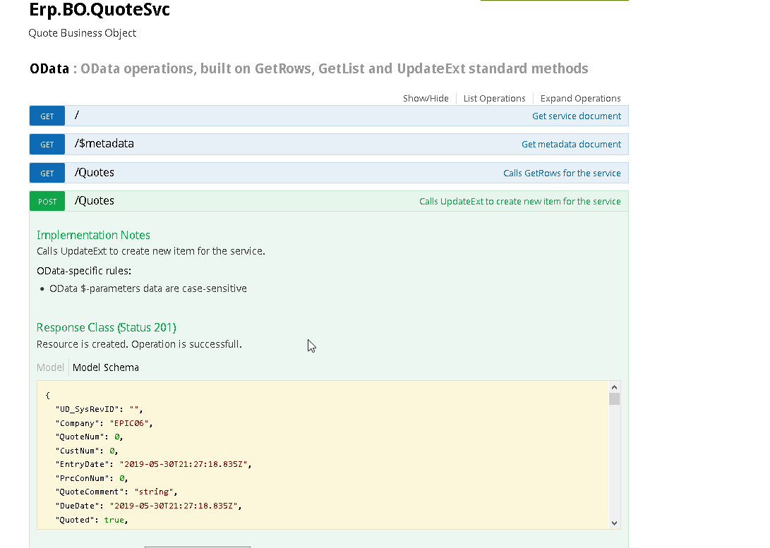

Looks like you are copying an example response and trying to send it. Instead grab the example parameter below it and to the right.

@smason as @Chris_Conn said you are passing in the response as the payload for the request. I am not trying to be rude here but it seems you are trying to jump in with both feet on something fairly advanced that you don’t yet have the understanding of.
