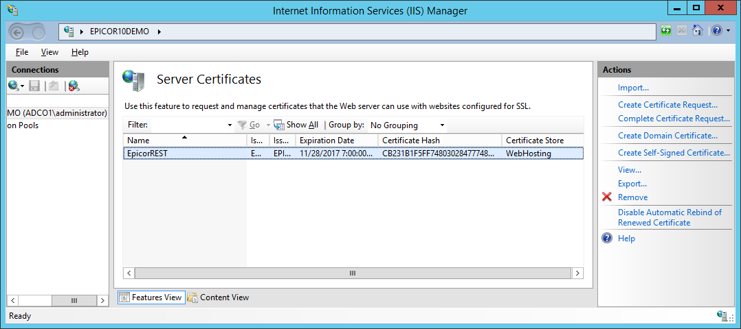

Actually I had forgotten, we have this site secured with let’s Encrypt too! :grinning:
And nobody even knew about it, check out the cert

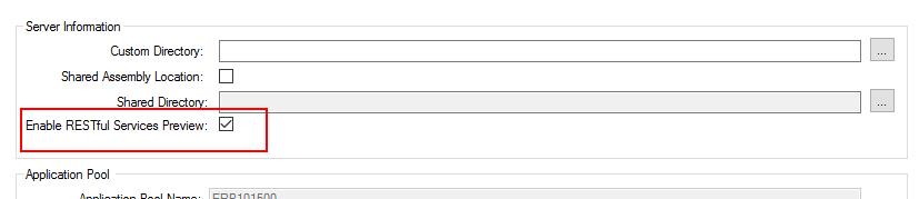

I am thinking it might be just a little more involved that a checkbox in the app server configuration :confused:
The following errors occurred while attempting to load the app.
  • No assembly found containing an OwinStartupAttribute.
  • No assembly found containing a Startup or [AssemblyName].Startup class.
    To disable OWIN startup discovery, add the appSetting owin:AutomaticAppStartup with a value of “false” in your web.config.
    To specify the OWIN startup Assembly, Class, or Method, add the appSetting owin:AppStartup with the fully qualified startup class or configuration method name in your web.config.

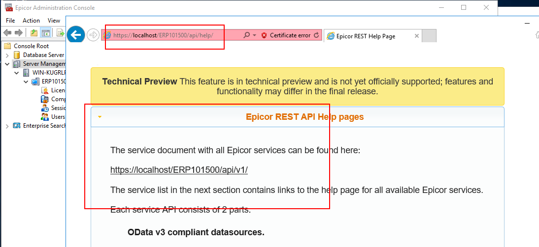

I have it working on several boxes this way, just check this box in server config, hit deploy

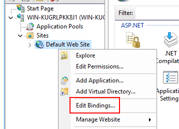

Then enable HTTPS endpoint in your IIS Website (Assing CERT)

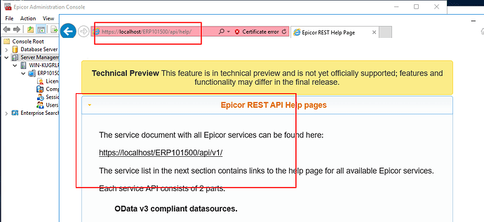

And navigate to
https://myserver/myinstance/api/help
If you have the cert assigned to the web site it should be just the checkbox. Can you post the web.config (sanitized) It sounds like the REST section did not get enabled correctly for some reason.
Don’t know if it makes a difference, but checkbox was not checked until today when 500.8 patch was applied

Is this correct location for self signed cert?
[cid:image001.png@01D24A52.18473820]
Yeah Bernie your Web.Config got screwed up some how, Yours (Left) mine (Right)
https://www.diffchecker.com/wg4KoIJD
I’d recommed you just delete / re-deploy your 500 just delete the Application, AppPool, LocalClient folder and Config in the Deployment Directory then redeploy with the same name (so it doesn’t break your existing clients)
Casue your web config is wayyy out of wack
It is just a demo server – I can delete the app sever and directories and re-deploy
I am the only existing client :wink:
Subject name for the certificate you use in Https setting must correspond to the site URL you connect.
So for localhost site, subject name in the certificate must be CN=localhost. (also localhost may be specified as SAN)
Re-deployed as new app server and works OK
The upgraded app server di not…
