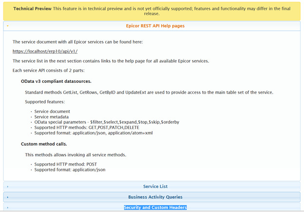

Remember I said api had all the toys here? What about help?

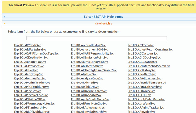

https://YourServer/YourShare/api/help

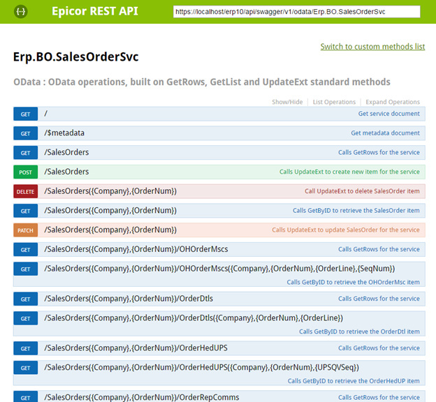

The REST services are their own documentation. Want to see what services are available? Click on the Service List and search for the one you are interested in. (Yea, we have something like 1600 services so added a search box there for you, try it out).

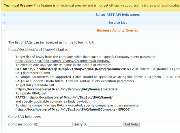

Also if you have spent a week building up that perfect shape of data in a BAQ, have no fear, it’s there. Start typing its name and you’ll see it appear to select it.

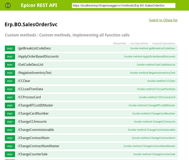

Once you find your service or BAQ of interest then you move onto the help page for that resource. Let’s look at SalesOrderSvc for a reference-
Whoa, swagger? GET / POST / DELETE / PATCH?
Let’s get some background. Swagger is a formatting standard to doc REST services. It’s one of the gazillion bouncing around these days with all the cool kids doing internet enabling refrigerators and IoT devices monitoring their dogs eating habits. Luckily it is actually really nicely done and helpful as heck. So we decided to leverage it. Microsoft Azure did also so we feel pretty good about using the same approach.
Get / Post / Delete / Patch is the http version of the Epicor core methods of GetRows, GetByID, Update, Delete, etc. These are standard verbs for HTTP and allows the Epicor REST services to play nice with other internet technologies. It makes getting the data in and out of ERP 10 easier with a variety of modern internet tools. This is not to say we don’t have the Core methods anymore though! If you look at the top of the page you will see ‘Custom Methods’. This flips the docs over to look at the entire list of service methods you are used to seeing in a client customization or in Visual Studio Add web reference:

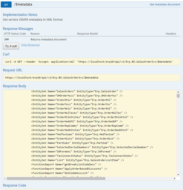

Let’s go back to the oData list and take a look at the $metadata resource. This is a standard ‘method’ on all services that list all the resources available for the service and the shape of the data going in and out of the service:
This is kind of a combination of a database ERD and an API reference all in one. It lets you know what is needed or available and a start to providing much richer documentation.

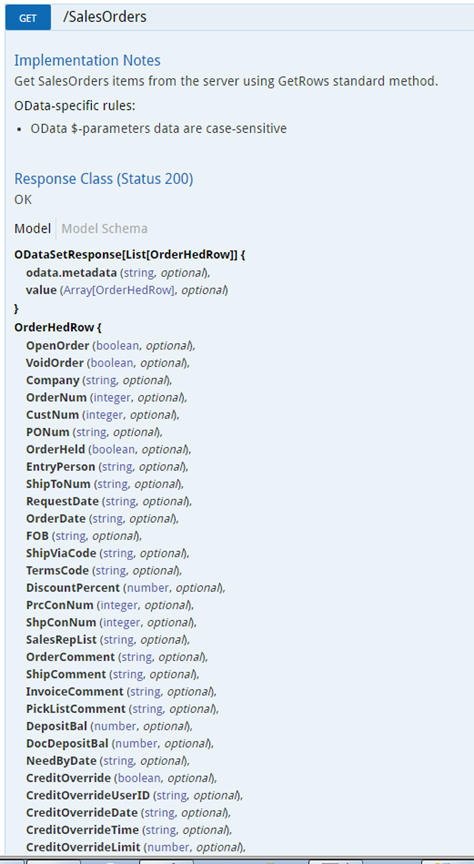

Now let’s drill into that original SalesOrder resource:

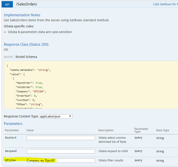

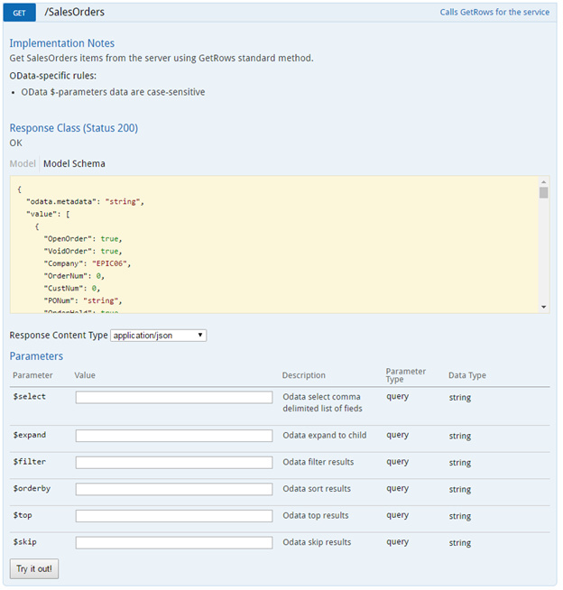

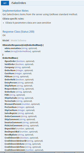

There are a couple of sections here. The upper section is the Model and Model Schema. The Model Schema is the shape of the data and some sample data as shown above.
The Model itself has a ton of information on the actual table and its columns:

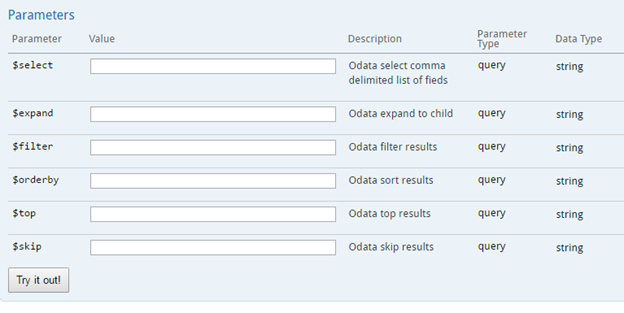

And this Resource has a few parameters it can recieve to start doing a ‘where clause’ of sorts.
These parameters and a bunch more are part of an open standard called oData (www.oData.org). A bunch of tools speak this language already – Excel, PowerBI, Tableau, LINQPad, probably a few dozens more I have no clue about. They send the ‘SQL Queries’ / ‘Where clauses’ in this format. You can leverage the tools and point them at the REST service or go learn the language at oData org, it’s YOUR CHOICE.

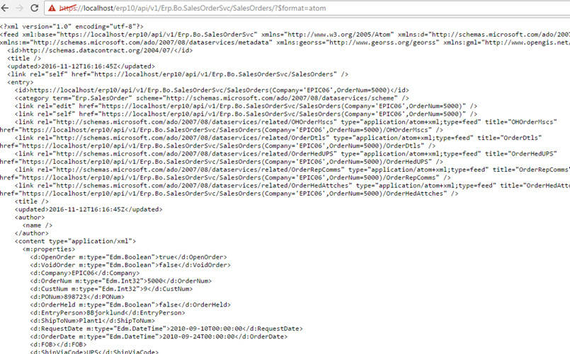

First, that json format is great for browsers but rough on integrations. To get the xml you are used to seeing you need to simply ask for it:
https://localhost/erp10/api/v1/Erp.Bo.SalesOrderSvc/SalesOrders/?$format=atom
We are starting to dig into the syntax of the ‘query string’. We start with a ‘?’ to tell the server I have a request on that resource. Then you tell it to give it to you in ‘atom’ format. This is a web standard for xml (Atom (web standard) - Wikipedia). If anyone remembers RSS newsfeeds, this is an enhanced version and plays great with data analytics tools like Excel and PowerBI.
What this means is as a consumer of the REST services, you can ask the server how you want the data shaped. You don’t have to do that in your client. We are trying to allow for flexibility in what you want and not force you to do the shaping of the data in the client.

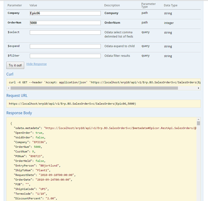

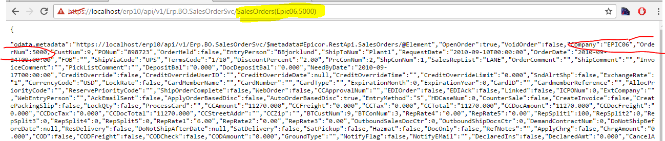

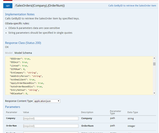

Note the first three records for ‘query’. Let’s note the first one and do a ‘GetByID’. SalesOrder as a resource has two primary keys to identify itself. A Company and an OrderNumber. The help doc highlights this for us and gives a hint on the syntax for the ‘SQL where clause’:
Note how the Company and OrderNum fields are prompting you to enter the primary keys. Let’s grab that first record retrieved in the List and ‘try it out’:
There is the record in the Response Body. Note the ‘Request URL’ builds the ‘query’ for you. Let’s try that in a browser:
We are starting to see the syntax in querying that ERP10 supports. It’s an open standard named oData (www.oData.org). Let’s pull it apart a moment.
/SalesOrder(Epic06,5000)
‘SalesOrder’ is the resource as previously stated. If you used OrderRels it would have queried against that table instead.
(Epic06,5000) is the where clause. Note above the help doc said Company and OrderNum were required. oData uses that requirement to infer the column values being passed and which is which based upon the order they were displayed in the metadata above. If you want to be verbose you could state /SalesOrders(company=Epic06,OrderNum=5000). Both are supported, again the philosophy of doing what is asked of the client or integration.

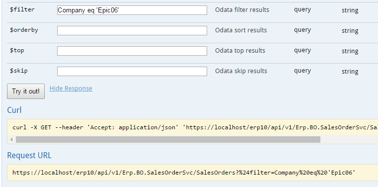

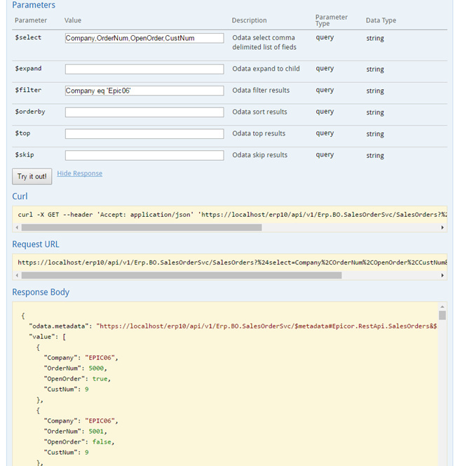

What about retrieving multiple rows like GetRows? Time to drop into more oData syntax and try out the filter command:
This builds out the URL:
Or in a browser address as →

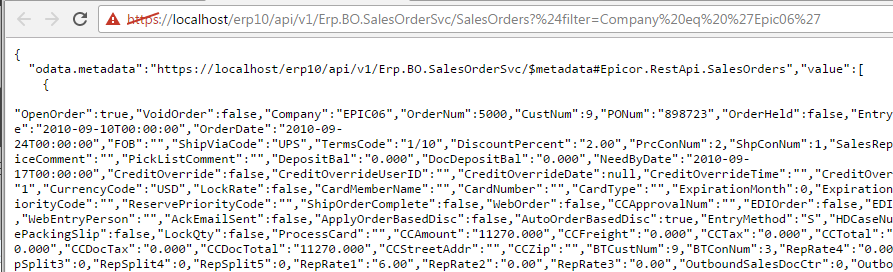

https://localhost/erp10/api/v1/Erp.BO.SalesOrderSvc/SalesOrders?filter=Company eq ‘Epic06’

We are looking at a lot of columns in these tables making it hard to understand!

Since this is an HTTP URL you have to follow all internet standards in making an address. ‘>’, ‘<’, ‘=’, ‘!=’ etc all mess up a normal URL. Instead of these oData has replacements:

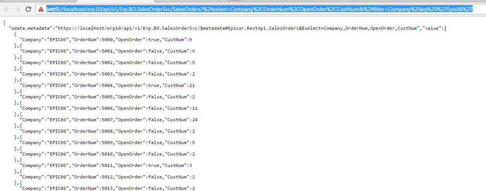

Lastly, there are some extremely verbose tables in many Enterprise systems. One of my favorite parts of oData is being able to specify just the columns I care about.

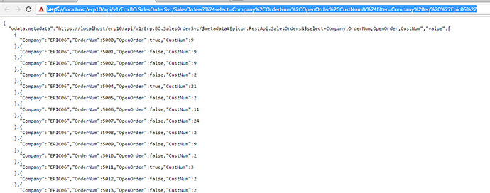

Maybe we only want to see the open order status and the customer number?
https://localhost/erp10/api/v1/Erp.BO.SalesOrderSvc/SalesOrders?%24select=Company%2COrderNum%2COpenOrder%2CCustNum&%24filter=Company%20eq%20'Epic06'
Wow, just the data you want almost like a BAQ?
Pretty much. Without having to persist a new query to the server or ask IT for a new service you can tell the server through REST what data and how to shape it.

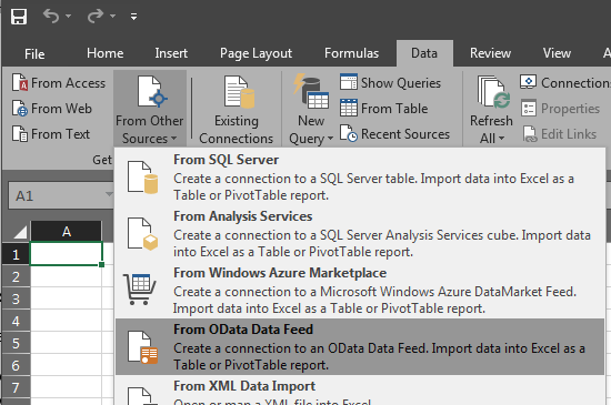

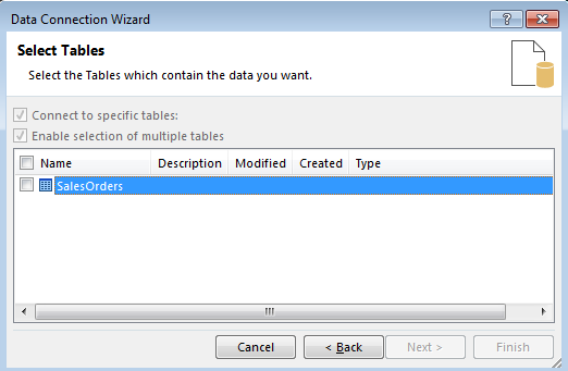

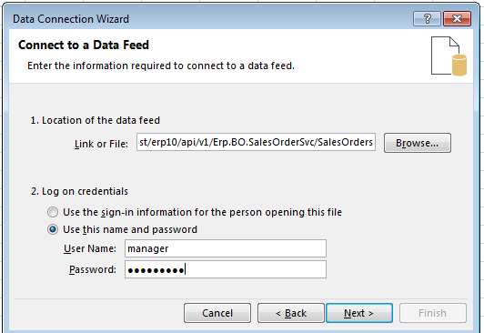

Not too many people are going to want to live their days in a browser to query the database though so let’s look at the world’s most popular querying client – Excel. You’ll need to refer to the docs for the appropriate version of when you need to download the oData addin from Microsoft but in the 2016 version it’s already baked in:
Let’s point at the SalesOrder service again with our ERP 10 user credentials:
And select the table you want to show

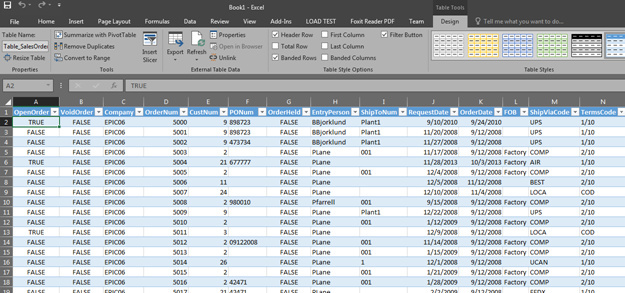

And you have a live link to the data behind the services with just client tool provided open standards. Nothing Epicor or Microsoft or anyone owns, just everyone agreeing to use an open standard.
The really nice thing about this under the covers is that Excel is speaking oData. Sorting, limiting columns, filtering of a column in the table all send across queries in oData syntax. This means you don’t dump the entire data base across the network and into Excel.
PowerBI, Tableau and anything speaking oData does the same thing.
