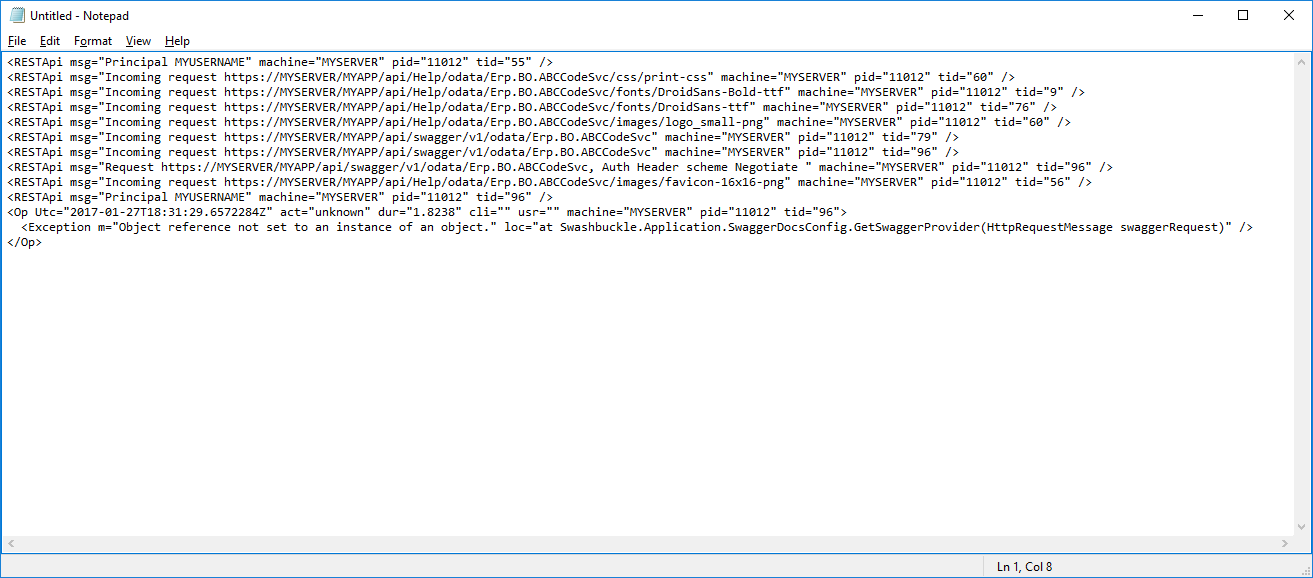

Nothing of significance. I’ve even run this from the server, and I get the same error, but nothing in the event viewer. This is what I get in the server trace log (after enabling logging for rest).
I should note I have Windows Authentication enabled on the instance web site. I was trying to get SSO working. If I turn off Windows Authentication I receive the same error from swagger on the ABCCodeSvc web page, and the same error in the trace log, just with the Auth Header scheme changed to Basic.

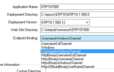

Try creating a WindowsChannel App Server and using it there… I suspect the SSO/WindowsAuth stuff is causing issues.
We’re currently using a Windows Channel app server. That’s why I tried using SSO. I’ll try setting this up in another environment. Maybe something went awry during initial installation.
After creating a completely new app pool, I’m getting the following errors in event viewer now when I try to get to the ABCCodeSvc in Help:
ERROR 1:
Epicor.RESTApi.ErrorHandling.ApiException: Incorrect service name. Example: Ice.BO.TipSvc
at Epicor.RESTApi.Misc.RouteMapping.GetTypeMappingFromPath(String svcName) in c:_Releases\ICE\3.1.500\Current\Source\Framework\Epicor.RESTApi\Misc\CommonFunctions.cs:line 43
at Epicor.RESTApi.ODataHelpers.v3.RouteHelper.BoServiceModel(HttpRequestMessage request, String[] segments) in c:_Releases\ICE\3.1.500\Current\Source\Framework\Epicor.RESTApi\ODataHelpers\v3\RouteHelper.cs:line 107
at Epicor.RESTApi.ODataHelpers.v3.CustomODataPathRouteConstraint.Match(HttpRequestMessage request, IHttpRoute route, String parameterName, IDictionary`2 values, HttpRouteDirection routeDirection) in c:_Releases\ICE\3.1.500\Current\Source\Framework\Epicor.RESTApi\ODataHelpers\v3\CustomODataPathRouteConstraint.cs:line 69
at System.Web.Http.Routing.HttpRoute.ProcessConstraint(HttpRequestMessage request, Object constraint, String parameterName, HttpRouteValueDictionary values, HttpRouteDirection routeDirection)
at System.Web.Http.Routing.HttpRoute.ProcessConstraints(HttpRequestMessage request, HttpRouteValueDictionary values, HttpRouteDirection routeDirection)
at System.Web.Http.Routing.HttpRoute.GetRouteData(String virtualPathRoot, HttpRequestMessage request)
at System.Web.Http.HttpRouteCollection.GetRouteData(HttpRequestMessage request)
at System.Web.Http.Dispatcher.HttpRoutingDispatcher.SendAsync(HttpRequestMessage request, CancellationToken cancellationToken)
at System.Net.Http.DelegatingHandler.SendAsync(HttpRequestMessage request, CancellationToken cancellationToken)
at System.Web.Http.HttpServer.d__0.MoveNext()
ERROR 2:
System.NullReferenceException: Object reference not set to an instance of an object.
at Swashbuckle.Application.SwaggerDocsConfig.GetSwaggerProvider(HttpRequestMessage swaggerRequest)
at Swashbuckle.Application.SwaggerDocsHandler.SendAsync(HttpRequestMessage request, CancellationToken cancellationToken)
at System.Net.Http.HttpMessageInvoker.SendAsync(HttpRequestMessage request, CancellationToken cancellationToken)

Are the RESTful APIs the reason behind adding all of these new Endpoint bindings that I didn’t see in Epicor 10.0? HttpBinaryUsernameSslChannel, HttpsBinaryWindowsChannel, etc?
If not, any idea what these are for and how they differ from the ones we had in Epicor 10.0?
I believe that most of these are for HTTPS deployments over the WAN… (Think SaaS)
REST does not use these endpoints,
They are for WCF clients.
Difference from e10.0 is these new endpoints are based on http, not on tcp.
Olga is correct. REST does not use WCF and is pure vanilla http(s).

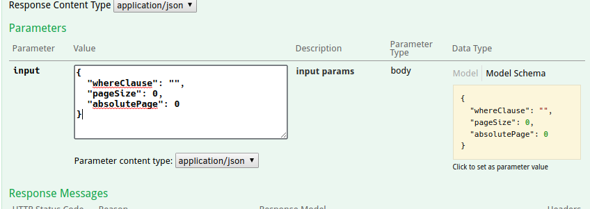

Hey Guys,
I have been playing around with this REST custom methods stuff but I can’t seem to figure out the whereClause part, for instance how would I get a list with all parts that start with or equals CMD1 etc
I have tried guessing the syntax such as whereClause : “{“PartNum”:“CMD1”}” but this is more mongodb style than anything .
I cant seem to find the appropriate help document for this whereClause so if anyone can point me in the right direction it’ll be much appreciated?
Many Thanks
