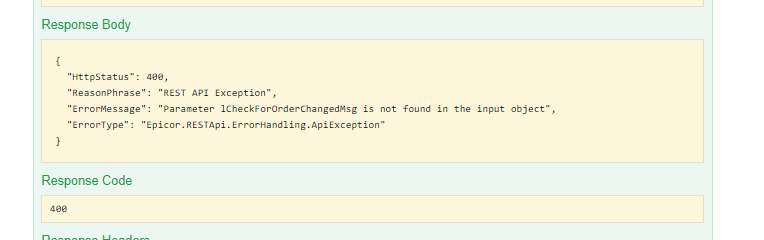

and I always received the following error
"HttpStatus": 400,
"ReasonPhrase": "REST API Exception",
"ErrorMessage": "Parameter lCheckForOrderChangedMsg is not found in the input object",
"ErrorType": "Epicor.RESTApi.ErrorHandling.ApiException"
except for the last example, but I am sending the parameter lCheckForOrderChangedMsg
