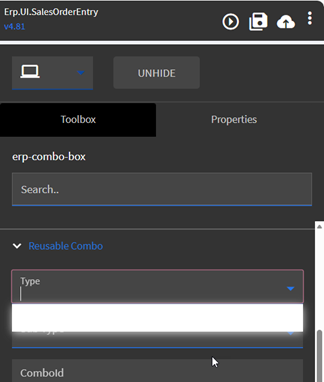

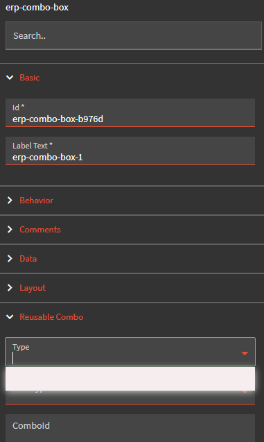

Reusable Combo Types Not Loading in Pilot 2025.2.7
In App Studio, anyone else notice the Reusable Combo Type and Sub Type not loading in Pilot 2025.2.7?

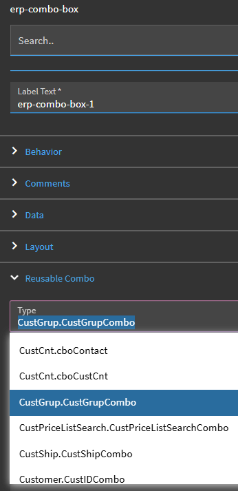

In our Live 2025.1.11 it loads fine to show options, just found it odd it is not working in new Pilot version.

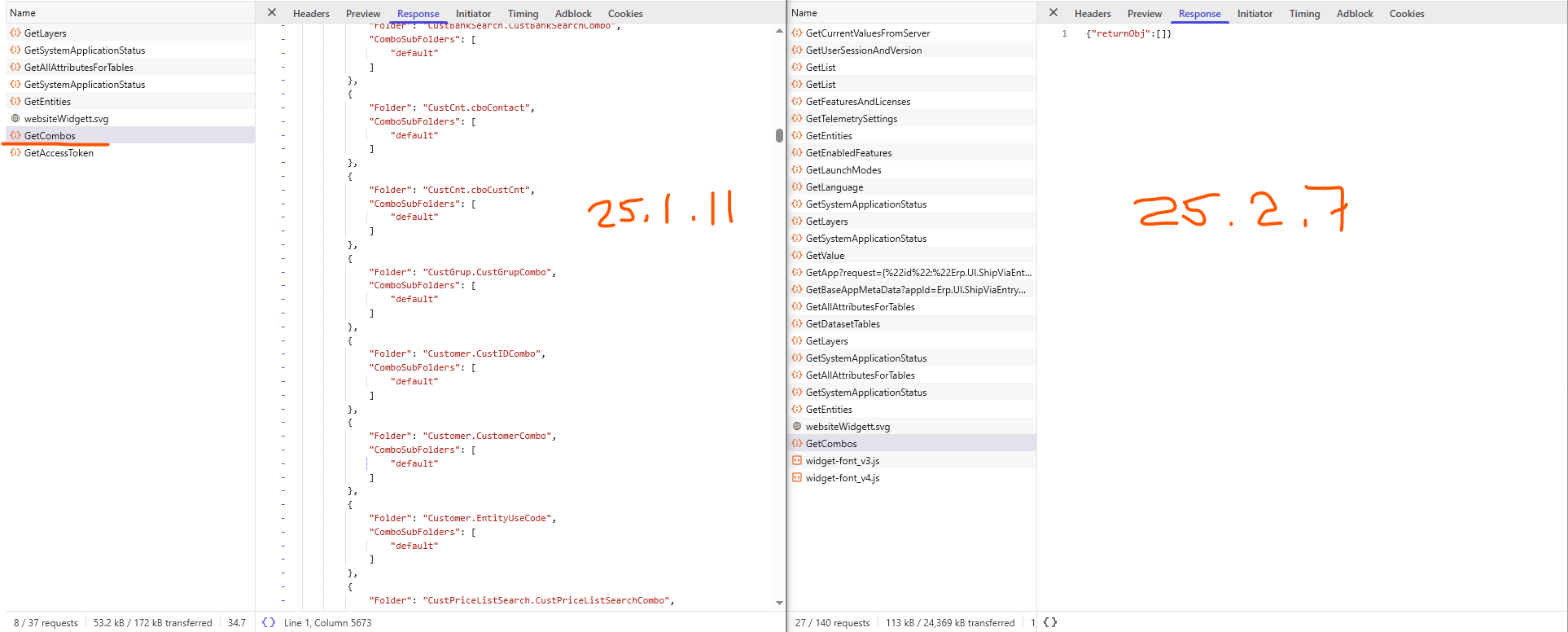

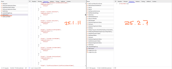

Same. Looks like Erp.BO.ErpMetaFxSvc/GetCombos
empty response - same on swagger…

Problem Description: After upgrading to Kinetic 2025.2.7, the Reusable Combo no longer works. That is, for the Type field, data no longer displays in the Drop Down.

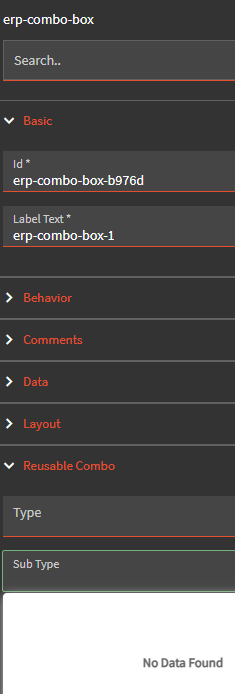

We’re on 2025.2.7, same behavior. Just opened another ticket. Existing reusable combos seem to still work, but still no values in the “Type” combo.

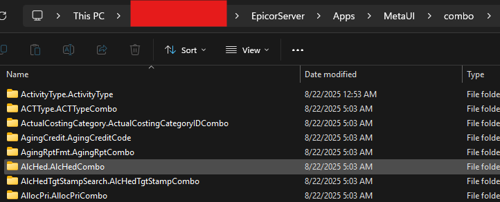

On server, these files are stored in the MetaUI folder, in “combo” folder, so maybe this will pull things in?

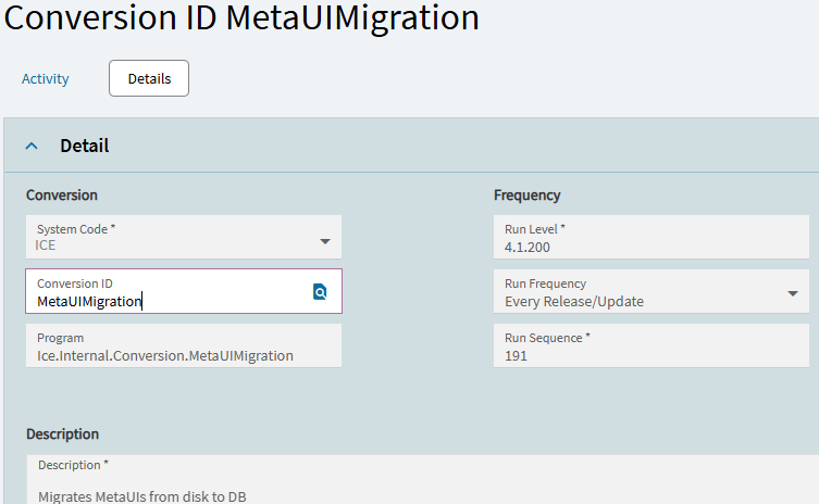

This process is supposed to automatically run every update, maybe it errored? Check the logs?
This is still broken in 2025.2.8 as well. Nothing populating in the type dropdown.
I tried rerunning that conversion from the conversion workbench but I’m still not getting anything in reusable combo type.

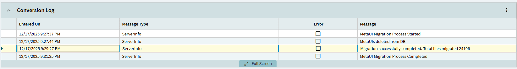

Any error/info if you check Logs in Activity tab on the conversion?
Nothing stands out as helpful.
Logged out and back in after it finished. I guess I could try restarting the site from the CMP? not sure that would do anything.
Seems like that should have pulled them given the numbers? Might be worth a shot recycling app pool/restarting site. The problem could be in the BO itself not pulling the info out of Db properly.

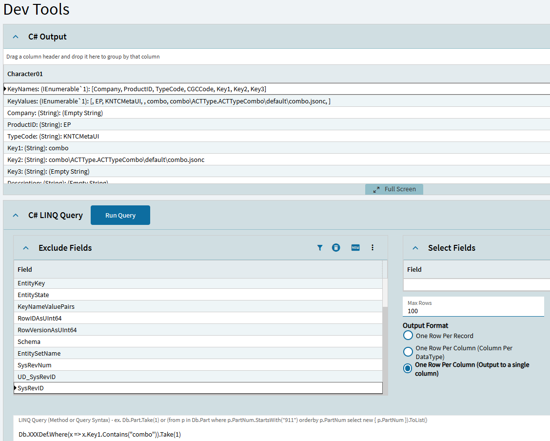

If you have my dev tools dashboard, try LINQ On the Fly, or you could do a BAQ against XXXDef where Key1 contains “combo”
If you see them in the Db, its probably the BO logic barfed in the update.
In Problem Repository it shows Resolved, but I also see issue is still there in Pilot and Live 2025.2.7. I just opened another support case for it pointing to previous one.
BAQ on XXXDef gives me 422 rows with Combo in Key1 so it looks like it’s there, just not populating.
