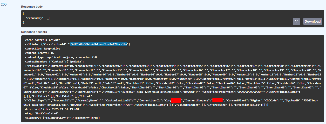

Someone should paste the GetCombos json response in here for folks reference in the interim.
This BPM (Ice.Lib.MetaFX.GetCombos) (Post) fixes the bug. Solution Workbench file attached.

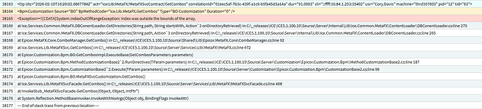

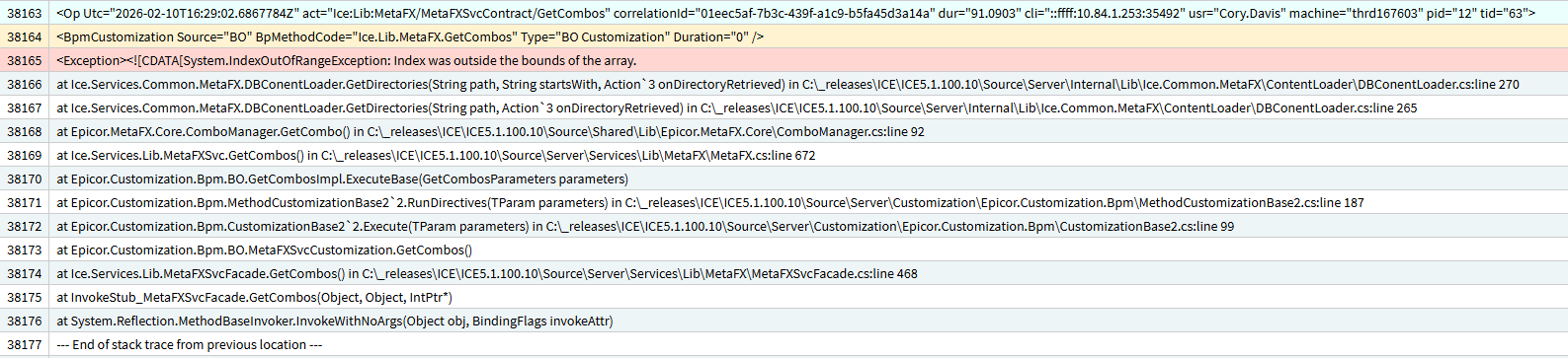

Don’t know if anybody else is running into this, but I’m now getting an error on the MetaFXSvc/GetCombos base method so the post processing bpm from above never gets the chance to fire. I’m on 25.2.10 hotfix-a with Linux OS now.
Relevant log:
put it on pre, and add MarkCallCompleted();
That worked. Thanks @klincecum! Now I’ll never know when they fix it lol
