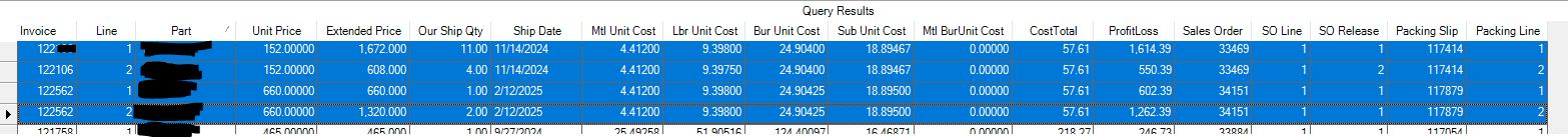

I slept on it, and wanted to come delete this post. The revenue per EH is just not a valid metric. So I am thinking about this again. When I pulled all my Invoice Details, I can see 4 shipments for the same part (2 invoices for 2 shipments with 2 lines each). The costs total the same exact value for all four lines. I would expect the cost to be different for each line as we shipped different amounts of parts.
Shouldn’t each shipment have a unique cost defined by the amount of work performed (and materials consumed) for the number of parts shipped? How can I figure out what level to roll up the costs under to get an accurate cost?
